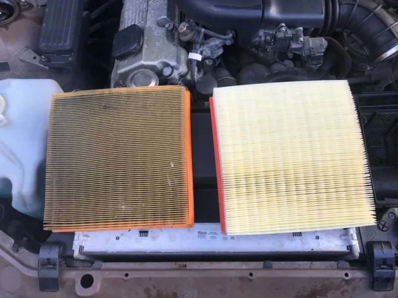

The other day I changed the oil, oil filter and air filter on my new Z3. It REALLY needed it! I then took it for a spin. After about 45 mins into the drive, my engine management light appeared on the dash.
I was wondering if you guys have had the same issue before, on one similar to mine?
My steps were:
  • Removed the air filter casing and then changed the air filter with the new Bosch one - set it aside.

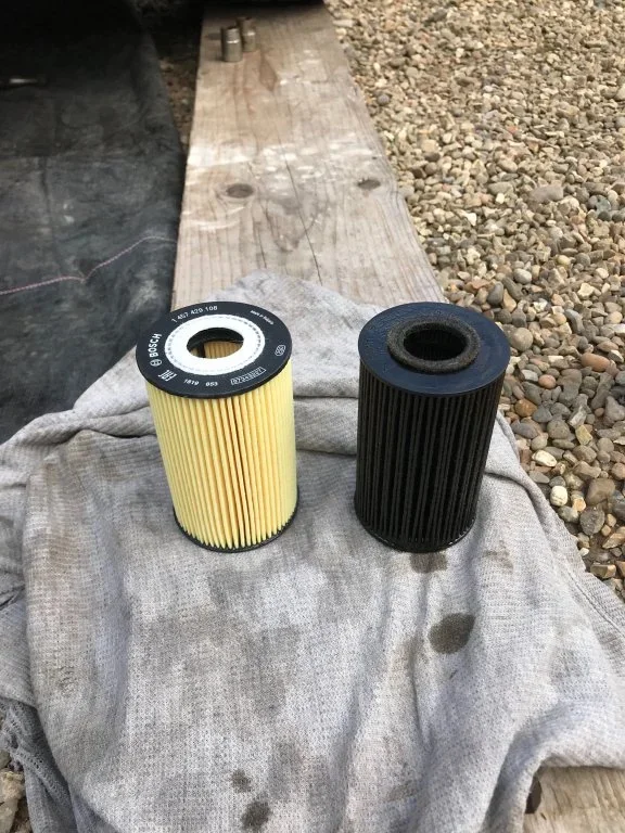

  • Removed the top of the oil filter casing and removed the old oil filter - set it aside.
  • Removed the oil drain plug and let the oil drain out into a bowl. The old oil was awful. - set the plug and washer aside.
  • Put the new plug on with the new Bosch washer.
  • Put the new Bosch oil filter in, also replacing the 3 O-Rings, and tightened the top back up.

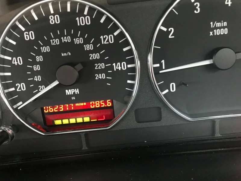

  • Reset the Oil Service Inspection Dial on the dash.

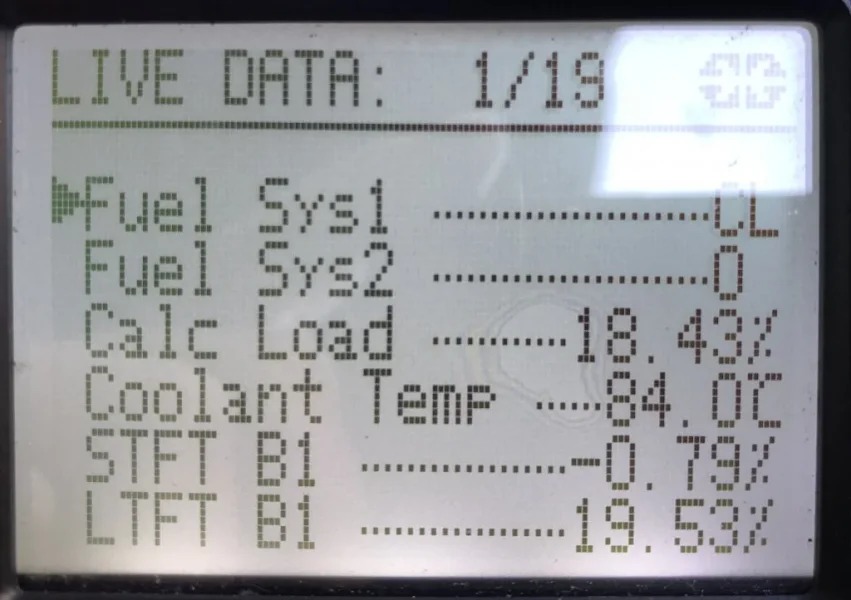

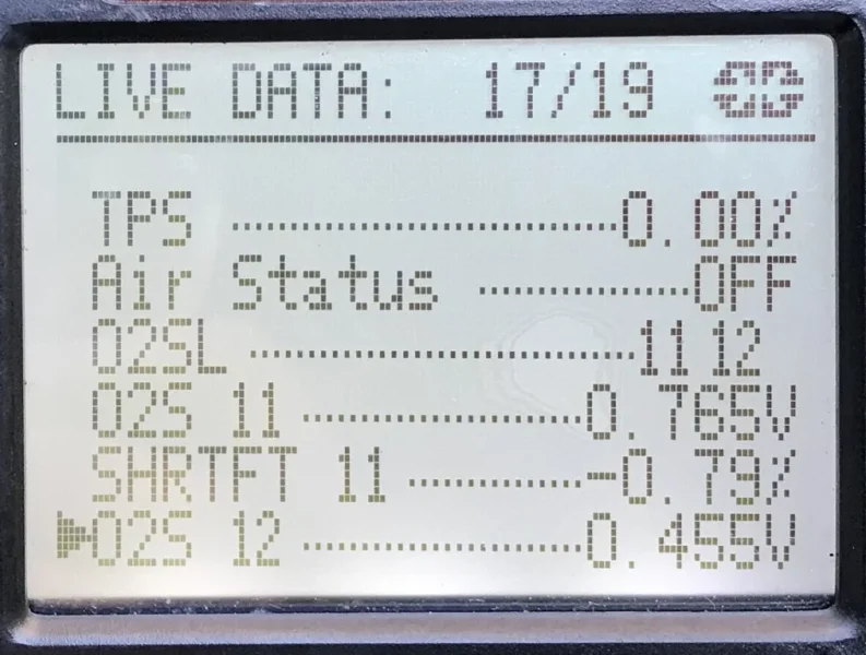

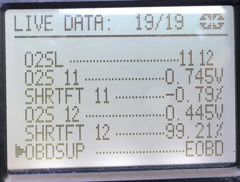

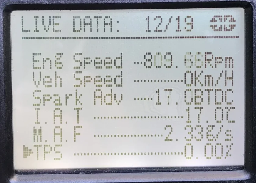

So I had a quick go on my dinner hour, but was also fixing the cigarette lighter on it.
I removed the air filter casing, had a check of everything that I could see (hoses etc), but couldn’t see anything wrong with them. I checked that all the hoses were on properly and everything was sat correctly.
I then turned the engine on and put my reader on it. Instead of two errors, it just came up with the Fuel Trim code.
I cleared the codes and I’m going to wait to see if EML comes back on again.
I also took some pictures of the live data (it might be useless but I’ve included anyway).

STFT = Short term fuel trim and looks fine suggesting no current air leak
LTFT - Long term fuel trim and I think 20% is the maximum adjustment possible, certainly it's way out, suggesting there's been a previous air leak.
Both are ideally 0% but +/- 3% is perfectly fine.
Conclusion is there is a leak and you've temporarily re-seated the rubber and closed it up. It will be back.
Thank you for explaining what they were haha! What would you suggest doing, based off the information we now know?

Yes would agree that Long Term Fuel trim is the cause of your EML, bound to be an air leak thats in there somewhere. If its not the intake bellows up to the throttle body its in any number of places. A smoke test is my preferred method of finding these type of leaks if visual inspection fails to find them. Smoke pumped in from engine side of the Maf will work its way through the system and reveal where its leaking from. Have seen small blanking rubbers at the back edge of the intake manifold be the cause when they perish and fall off introducing an air leak. Also seen cracked plastic cam cover on a 2.2 be the cause of high fuel trims at 20%. Out of interest have a look at how the Maf is reporting in live data when you rev the engine up, see if it increases as you open the throttle.
