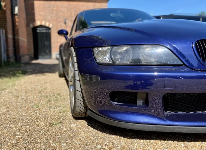

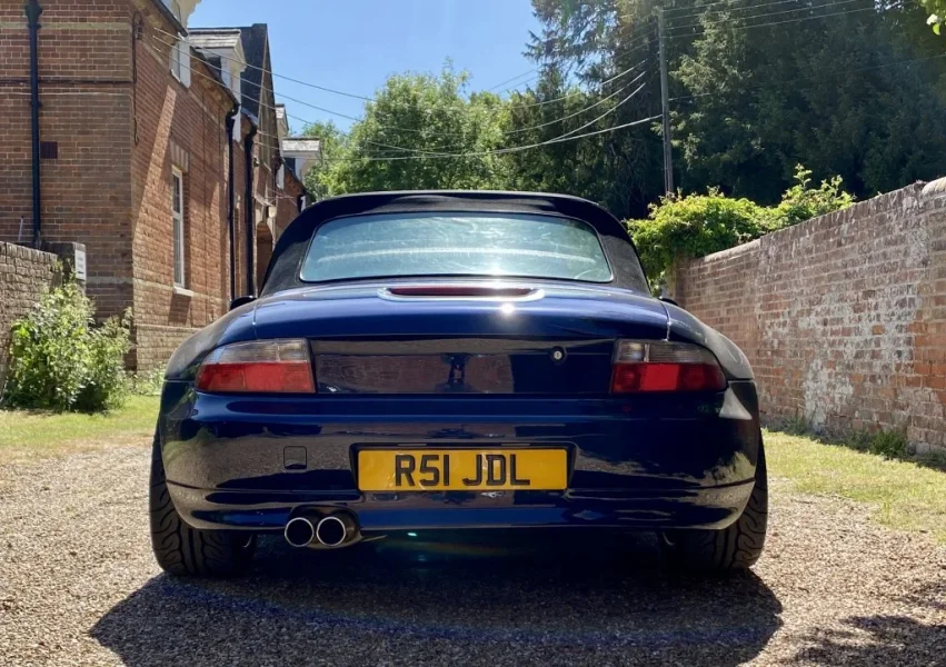

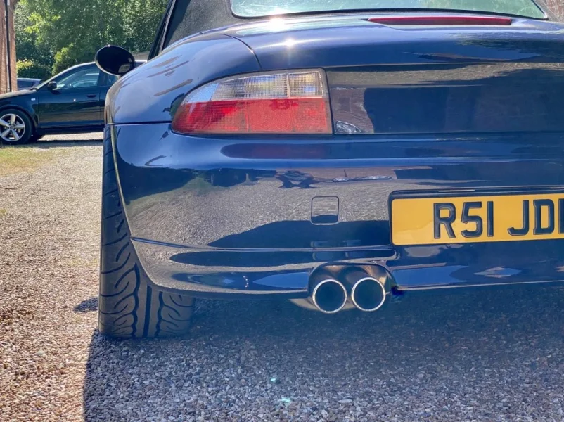

The other style 194 arrived so test fitted on one side with 25mm spacer at the rear.
The Falken 453 in 255/40 that they are fitted with actually measure 266wide so poke at the front. With the 245 (which measure 249) that I’ll fit to them it should be spot on.
The looks are growing on me - they look better in the flesh than pics, they have quite a bit going on with the design. Has quite a meaty look, not what I’d run all the time but good look for track.
Left side with wider wheel and right side with its usual 235 on a 7,5j
Looking great @Dino D. Never looked into 194s but it certainly works under the arches.
Really interestimg to see that the 255/40 measures more of a 266. I've see. Some 265/40 available for decent money. Could be assumed that these could end up 275 wide...
That's some pretty serious negative camber on the rear. They are effectively et 8.5j et 12 on the rear. What's the idea behind the chunky spacers?

This site is great, has data on actual tyre widths and measure rim etc: https://tiresize.com/
Varied by barns and model.
the camber is spot on - looks more exaggerated on 17’s than it did on 18’s but is normal for a lowered car - the mechanic who races BMWs is happy with that for a road and track car, he wouldn’t bother with the welded plates etc. Unlike the internet that tells you all about wheels falling off and grip/scrub radius blah blah I’ve been running it like this for years and and if the mechanic who races is happy I’m happy.
I may go down to 20 once I have the tyres on as these are wider.
It definitely needs it with the 7,5j rims as they’ll sit too far in and handles very nice and neutral like this on track.
