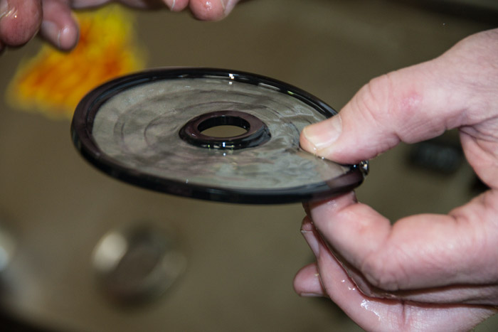

I went on a tour of Mackie Automatic Transmissions the other week
One of the things they do is to hot oil flush the gearbox to remove particles down to 5 microns - this is a filter, you could feel the metal in the oil
