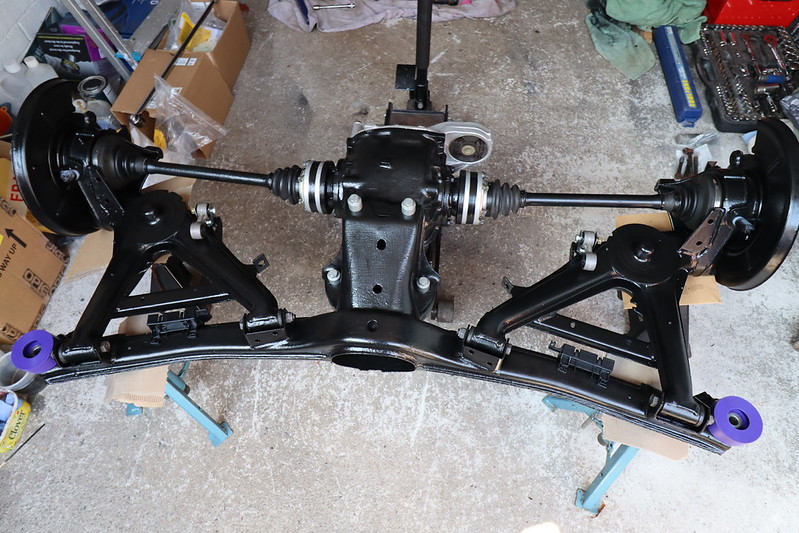

I had seen that one on eBay. Anyone with better eyes than me..... Can you confirm just by looking whether it is actually the Z3 M suspension or not? From what I understand, when they beefed up the rear suspension for the M version, they changed the subframe and the trailing arms. Are the ones in the photo actually the M versions or not? It’d be a nightmare to go through the hassle of getting them all the way from Lithuania to find their the normal wide body version………!!!
I can confirm it is. The rear diff cover along with swing arm webs are clear indicators.
Thanks Lee - I’ve got some research to do, mostly on Lithuanian transport………!!! 🤷‍♂️🤷‍♂️🤷‍♂️
If you buy it I would use credit card with your PayPal for extra protection. You could ask the seller if he would be willing to sell just the beam and trailing arms or keep the rest and refurb as spares or sell on. Shame there’s no cheaper options at the moment.
I’ve bought stuff from Lusitania before and had no problems.

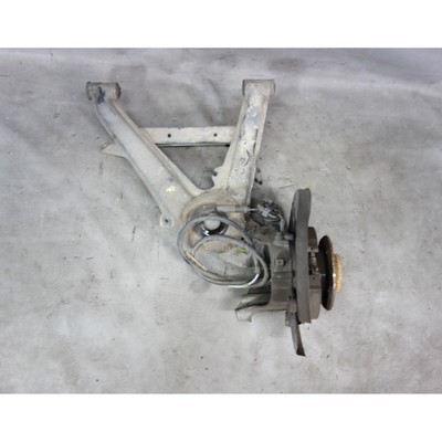

Are the webs the cross braces on the swinging arms were these only fitted to the M version ?
That brace is wide body arms, the M extra brace is the vertical brace just next to the half shaft as it meets the wheel bearing, it has a couple of holes in it. This is only on M arms.
