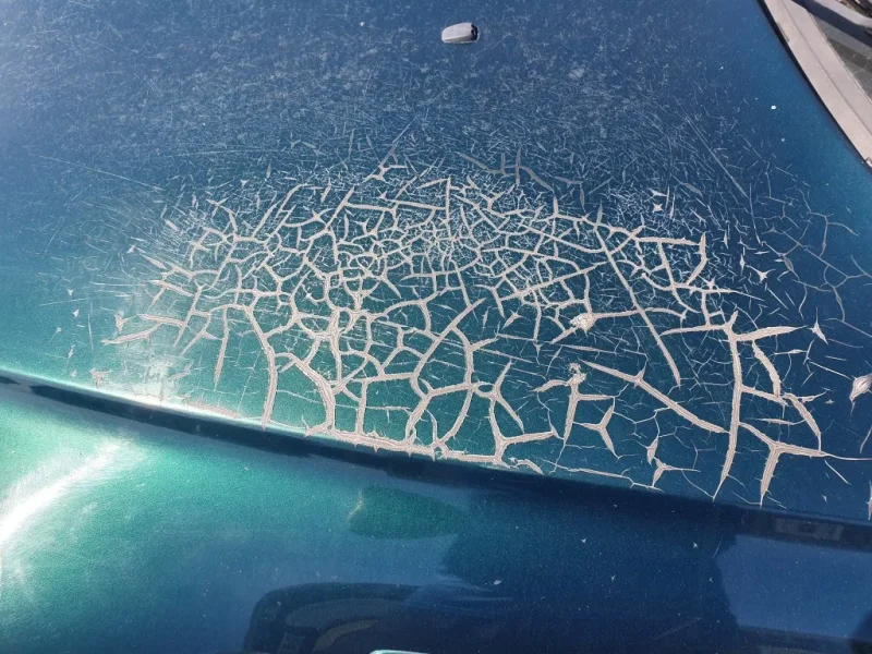

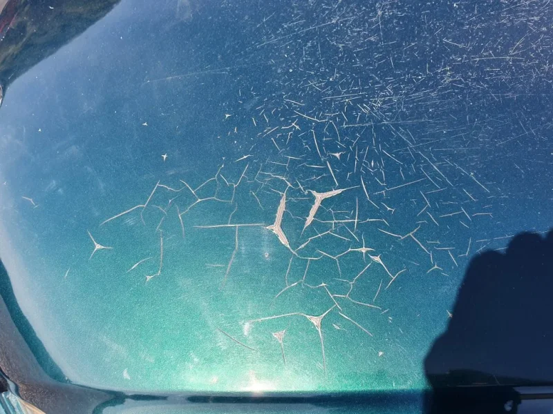

Think it might be Boston Green.May be cheaper to look for a second hand bonnet in the same colour is it Topaz?
You got rid of a dazzle paint scheme by mistake!Different types of paints can react with each other. One of the ships I deal with was painted with one chemical type and then at a dry dock painted with another. I created a magical crazy painting down the side similarly to what you have but on a much larger scale. Only way we got rid of it was to fully blast it back to bare metal years later and paint it again.
Hi Thanks for advice, what sort of money you looking for? prob be too dear too far for delivery? pity you weren't closerThink it might be Boston Green.
I have a black bonnet here I can let go cheaply if it helps at all. It might save going back to bare metal.
Hi, thanks for replying, no its Boston Green, not a lot of 2nd hand ones about unfortunately. getting quote for paint job tomorrowMay be cheaper to look for a second hand bonnet in the same colour is it Topaz?
I had the same issue with a previous Zed. It’s most likely a bad base coat that has reacted with the paint. Only way to sort it is taking it back to metal (lot of work).
I also think that a wrap would still slightly show the depreciations of the cracking once it’s been in the sun for a year.
I would suggest getting a good second hand bonnet and getting it painted.
