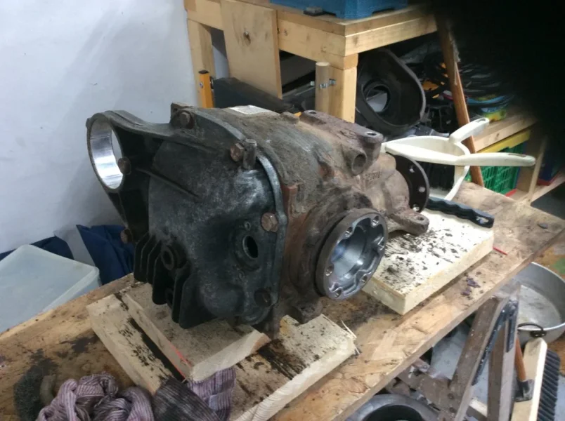

One scruffy looking diff....

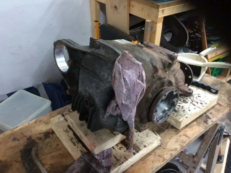

Two hours of rust flying everywhere later...

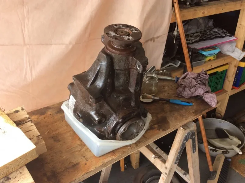

Sitting draining the last of the oil out, and with the rust treatment drying.....tomorrow it will get a coat of high temp black paint.

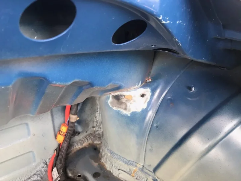

Then......I had a visitor......

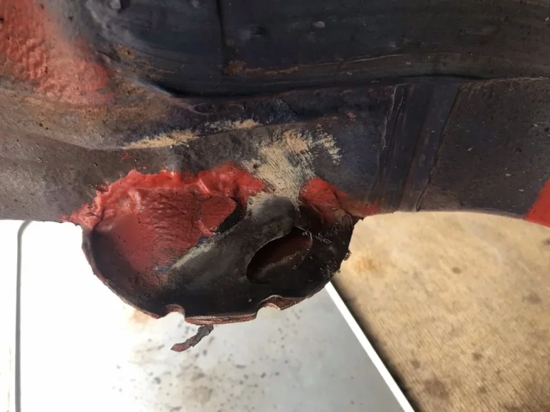

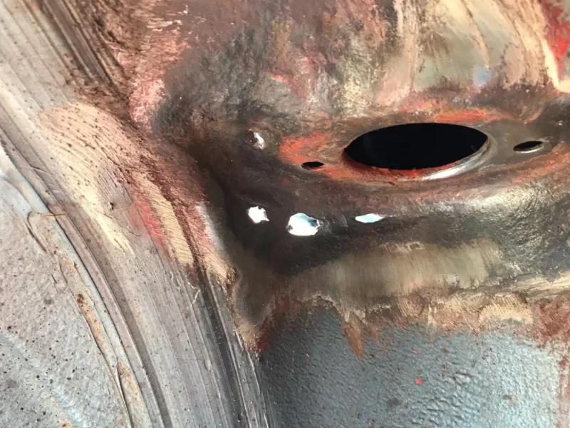

Hole.. :arghh:
Bigger hole.......:arghh::arghh:
No Hole...:):):)
And the small holes up by the shock mount also sorted..
By firstly cutting it all out......made an insert piece....
And all solid again....
Red oxided , then some paste was put on to fill the seam. Hence it went pink !!!! I could repaint the car to match:whistle:
( it will be blown over with a rattle can later, when I get round to finishing the underneath)
The guy who did the welding was really good and definitely will go on my speed dial list:thumbsup: Thanks to Mark,( @Althulas) for finding him on FB for me.
