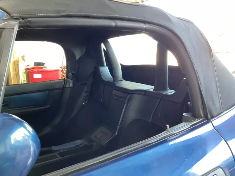

Put a bit of effort in today , and with the help of my mate, finally got the roof fitted.
I bought some Upol Tiger Seal but was never sure if it was the correct sealant to use ……as it was an adhesive sealant.
Anyway after chatting to Ian ( my Mate) we decided to use the butyl strip as per the manual….and it was a good decision as I think had we used the mastic it would have got everywhere……. :whistle: :whistle:
First thing was to check the plastic bow that I had previously installed. The 4 bolts were only fingertight and I found that the bow had dropped a bit so the holes didnt line up :banghead::banghead:, It was fixed with the same butyl so with a bit of persuasion managed to realign it and tightened up the 4 bolts to hold it in place.
Next was to add the butyl to the plastic bow and fortunately there is a guide to show where it goes.
This was a lot easier that last time I did it , as Ian fed out the strip from the reel and I placed it into position.
Because I didnt want to have any leaks I decided to add a second layer… so pulled off the release paper and repeated the process. (The grey butyl is 15mm wide x 2 mm thick…. So I I ended up with it 4mm thick)
Before picking up the roof to install it , I pulled back the release paper on either side to just before the bend.
This is because its really tight in this area and I didnt want the release paper to break when trying to pull it off.
Then it was the point of no return!!!! =))
We lifted it in, dropping the back in first then got the drivers side in and on the studs, then with a bit of pushing got the passenger side in..
With it in the closed position but not fixed at the windscreen, lined up the centre screw at the back and put it in finger tight.
Then added all the rest of the 15 screws that hold the metal bow ( total is 19 but the other 4 hold the plastic bow only)
Put the frame fixings in , 2 nuts and 1 bolt either side, And screwed them down, but at this point …not tight.
Next was to tighten all the bow bolts … started with the one in the middle and tightened it, then next one along on the left, then one on the right , and so on until all done.
After locking the roof shut the frame nuts and bolts were tightened.
To finish off I put the rubber seal round the back of the roof
and then connected the lead that runs to the microswitch in the roof… the mating half is fixed to a bracket held by a roof frame nut Also on the passenger side, clipped the piston to the ball joint located on the frame..
Been really dreading doing this job, but went better than I was expecting. Certainly having help made all the difference.
Thats as far as I got today… but so pleased its done. :thumbsup: And the roof seems to be nice and tight, and hopefully fully sealed :eek:
Might start to put back the interior tomorrow :whistle:
