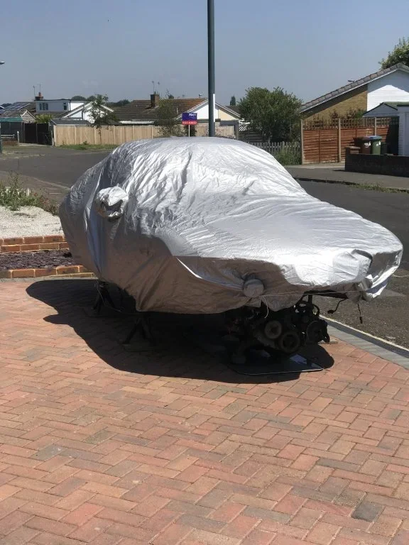

Then final thing was to put a full cover over the shell …. not such an eyesore with a cover =))
Now just need a willing helper to get the bonnet and roof off……..
At least the sun was shining as it always does in Costa del Bognor =))
