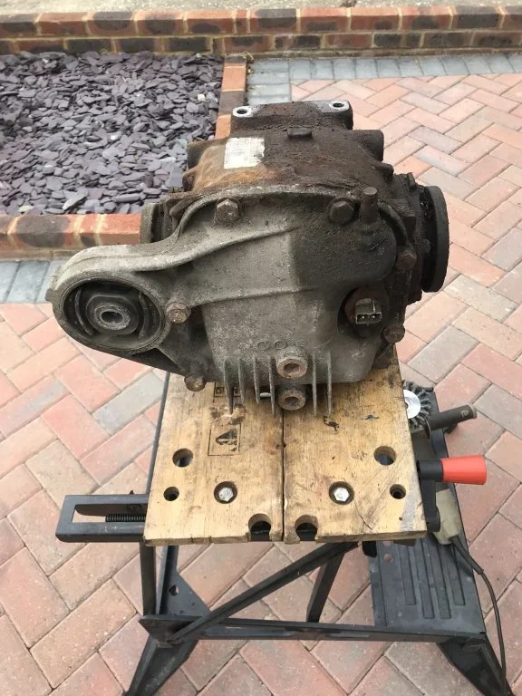

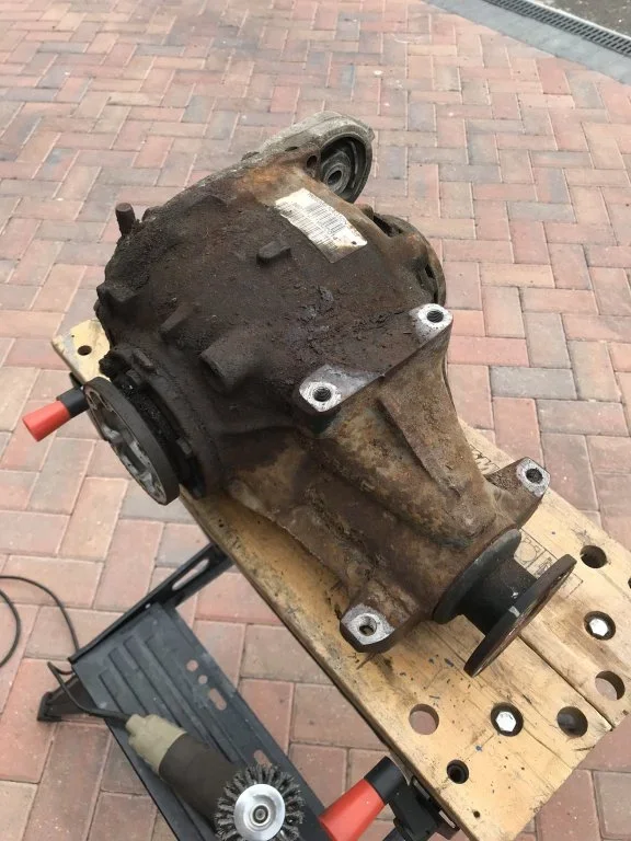

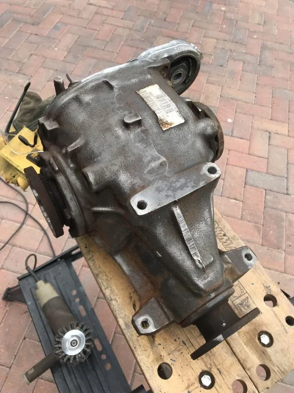

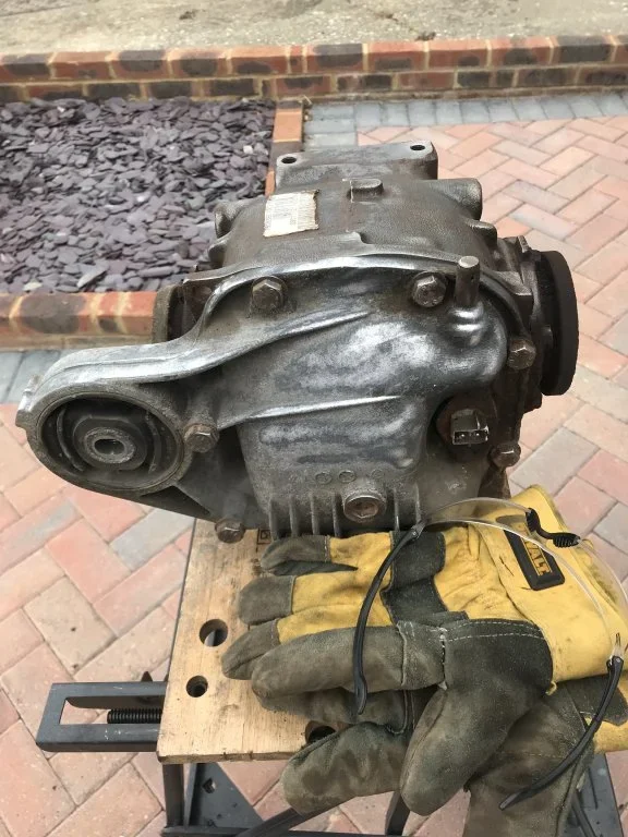

Got out into the garage this morning for a tidy up….. but got side tracked….
Put the near side disc and calliper back on and connected the brake lines.
Bit of an accident when I trod on this and so had to ‘gorillatise’ the end back on :whistle:
Then thought I see how well the spare diff would clean up…..
Ten minutes the wire brush

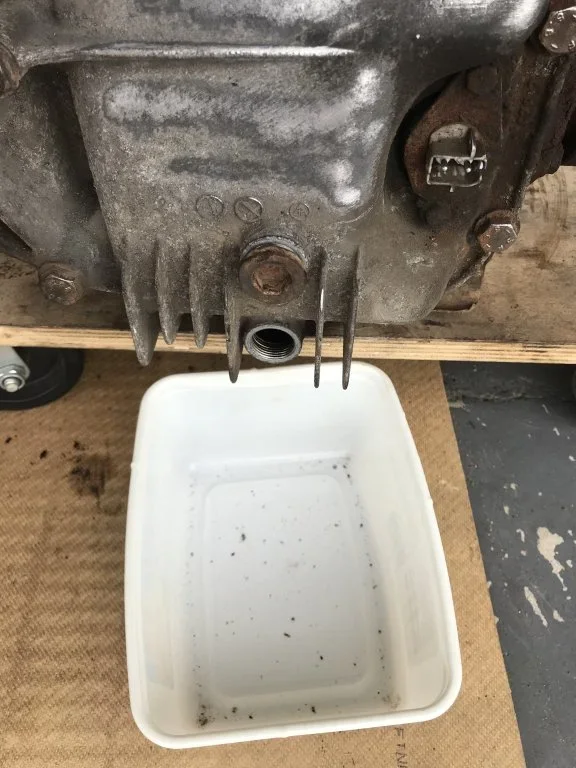

Thought I better drain the oil before turning it upside down….
Hmmmmm… thought there would be more than that=))=))
I think it was upside down in some photos when I bought it …. Must have already drained…. Saved me the job:):)

That's in far better condition than my old one Malc. Looking good:thumbsup:
Good job you checked if you are considering using it! ... would have been a very short and noisy first drive otherwise
I know you get Dry Sump sports cars...first I've heard of a Dry Diff one! 😀
Bloody hope not !!!! =)) =)) =)) =))
