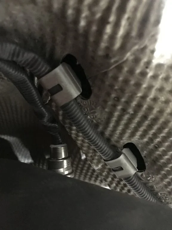

Anyway not a problem swapping them over in situ, but missing a few clips.
Four of these…
They clip onto the heatshield
I had 1 good one, 1 broken one and two missing:arghh:
They keep the cable from dropping down on to the exhaust so reasonably important

So first job was to fit the 4 cable holders to the underside of the car and hook up the sensor wires.
Thats the exhaust done except for the rear tips.
