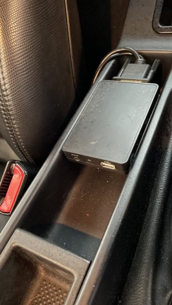

Exactly the one I have. works great. If you are not interested in aux, or usb you can hide it inside the glovebox, or behind the radio inside the dash.

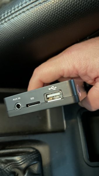

Thanks. I got this device based on your recommendation.
I want to have a way of accessing at least the USB port, so will look at the best way to install next weekend. I like where you have the unit. Will try to find a way to route the cables kind of concealed. Any tips?

do you have the “viber” app? You can call me and I can show you real time. Or skype/teams or something similar.
its pretty simple. Remove glovebox and console side panel, (some philips screws covered in plastic caps) pass the cable under the side panel and then push with your fingers under the center console all the way back.

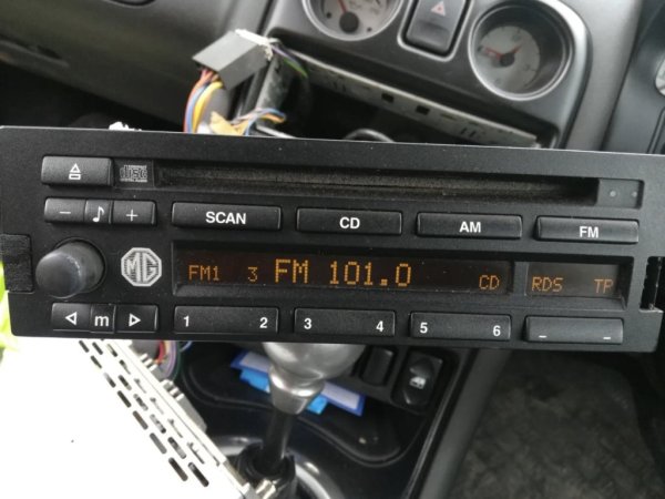

Can anyone confirm if this is Orange or Yellow illumination?
That's certainly a yellow/orange display. Obviously MG, as per picture.
Note: at the time BMW owned the Rover/MG group, and to save money (synergies) the same stereos were used for the three brands. ~ The Rover radios, which are harder to come by, had the same red LEDs as the BMW ones. Again, they are all the same units, just different branding.

No, it will not match the illumination.
I was very keen to get the look just right, but in the end I decided that investing in mechanical fixes was better that just splashing money on a CD43. Besides, for my car, the C33 radio/cassette would be the age correct one. That sounds even worse than aftermarket ones and doesn't allow for any of the Bluetooth adapters to be added.
In the end, I just went for MG CD43, as it is effectively the same unit that would be installed on BMW, but the display will not match the colour scheme:
This looks much more like yellow, but the colour is really orange, and matches the colour of the display in the speedometer (miles, service, etc.). Why even the original lighting is not all red, I don't know...
