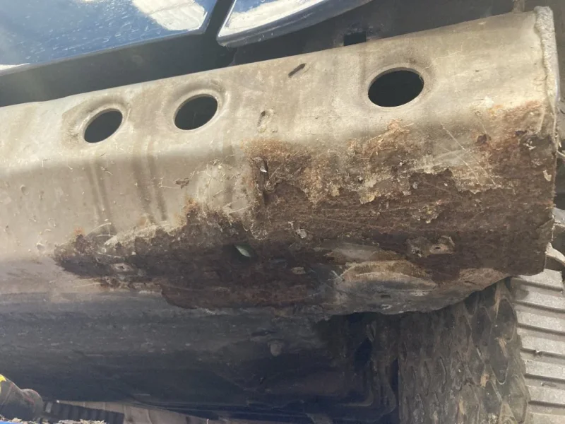

Nothing really, if the MOT tester knew what they were looking at they would know that the sill cover is merely "bodywork" and as such not a testable item.
What did the MOT person see that prompted an advisory in the first place?
This is what he could see. The cover is the right hand side of the picture. It’s muddy but good. The corrosion is underneath.
It wasn't the sill covers that the tester gave the advisory for, they were fine and not very old, it was the inner sills, the rust had spread out from under the sill cover and was visible, hence the mention, good call IMHO as it prompted the removal of the outers and the inners caught in time before more damage was done.
In that case I would agree.
