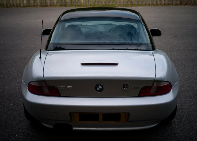

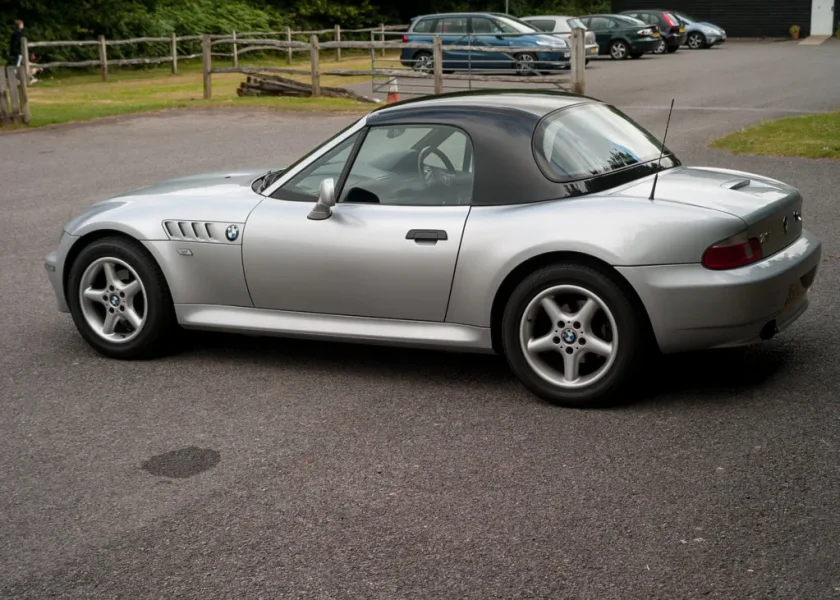

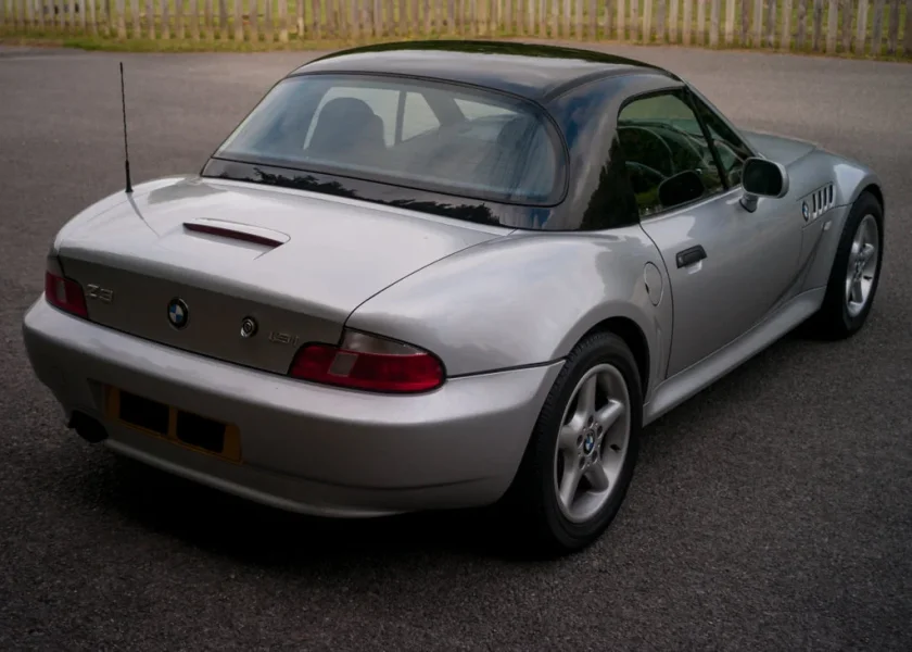

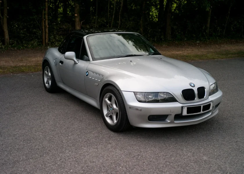

Thought I'd post a couple of pictures taken on the way home in case, like us, you were wondering if you really need to match body colour. Rob was also able to supply a set of matching Side Vents but you will need to wait until winter to see those. While a hard top is not a necessity it certainly makes things easier when it drops below freezing.
On initial fitting there was some wind noise - easy cure was to undo two front bolts, slacken off the three bolts securing each front plate, then re-engage each front bolt 3 turns to align the plates, tighten up the three bolts on each plate and finally tighten the two front bolts. This worked for me allowing the front edge of the hood to drop back a little while also dropping down slightly to find its natural fit.
For any new Zed owners reading this I suggest you look for the fixing kit before you buy a hardtop.
(in case you are wondering its Sapphire Black, not Jet Black)
