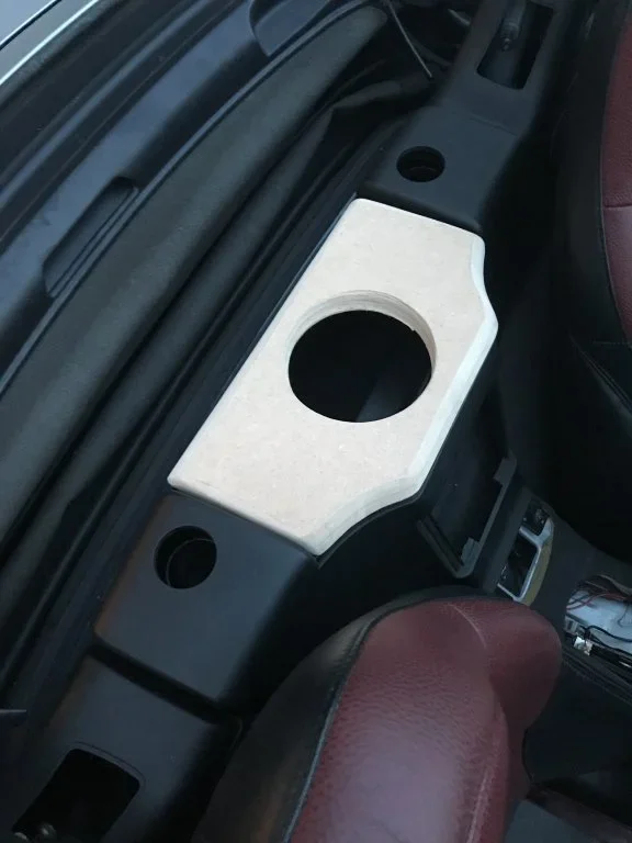

Moved things on a bit today but not quite as straight forward as I expected, I think I may have made the box a little larger then it should be but I'm really pleased with the end result as it couldn't possibly be a better fit, however it did take some modding of the original equipement
Firstly I cut the ends off the cubby so that the caps have something to mount too
also the brackets that the lid hinges to needed cutting down as to keep the integrity of the outer box
More luck then anything else and it fits really snuggly, its also now covered in acoustic carpet
