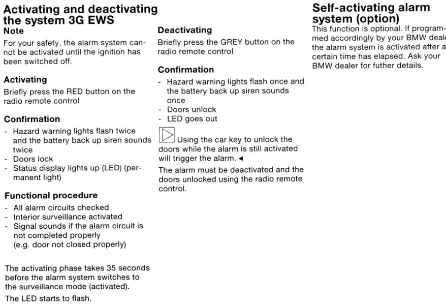

Hi - if it beeps twice then it is trying to set the system - if a long beep follows then it is indicating that a contact on the circuit is not made.
I would start by checking the bonnet switch . You can unplug this and then test system again - note there is a spare plug in the same area so ident which one you actually unplug so not to confuse ( don't ask me how I know this :oops:)
Edit extract from supplementary manual
Thanks for the info pal
