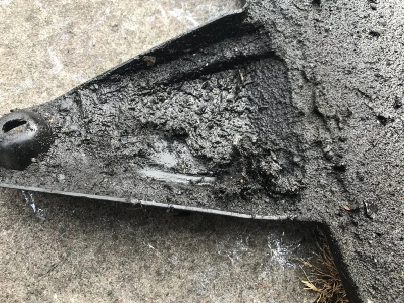

ok so I was going through the process and takingdrivers side outer sill off to see how much rust had eaten into the inner sill, my trolley jack went right through the jacking point a few weeks ago.
look what I found , I didn't know zeds came with allotments.
Jacked through
Anyways good news is it's only rusted through a small patch which should be easily weldable
However I noticed water must have ingressed through to accelerator pedal mounting area making the metal soft ,again another patch will be required
Got me thinking though that this is not an obvious place visually for muck to build up and if z3 sills have been on a few years might be worth checking out. Just a thought
Anyway will endeavour at my own pace and maybe one day will get her back to an acceptable standard

View attachment 63331 ok so I was going through the process and takingdrivers side outer sill off to see how much rust had eaten into the inner sill, my trolley jack went right through the jacking point a few weeks ago.
Jacked through

You might be underestimating the size of the patch required. I can see up to maybe 12" of suspect metal.
Which would include the jacking point which looks suspect anyway.
I really would think about a donor section for that let in flush. Not just some flat sheet bashed into shape by the welder and patched over.

I would advise you finish removing the sill covers and arch liners to make a full assessment. In case there are other areas of rot causing you to rethink viability.
No problem doing it. As I say it's just when.
Had full assessment done of full car and both inner sills, passengers side back needs done but the other 2 corners just need treated. good news garage said the welding cost will be around £200 but I need to do the prep,
Guy checking it has several classic cars and said he thought she was worth saving
I was thinking over the weeken she might be a forlorn hope, but today am really happy , and hopefully I just might make zed fest next year

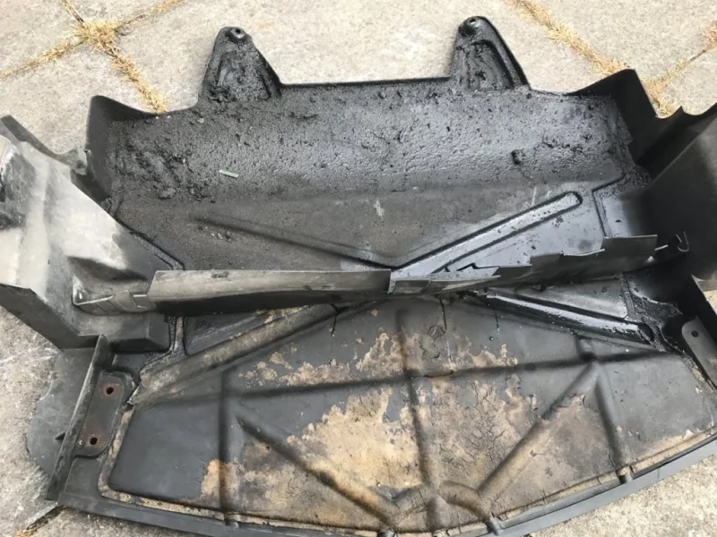

More crud to play with , this time front splash panel , disgusting mess, previous owners five years worth of oil leaks
