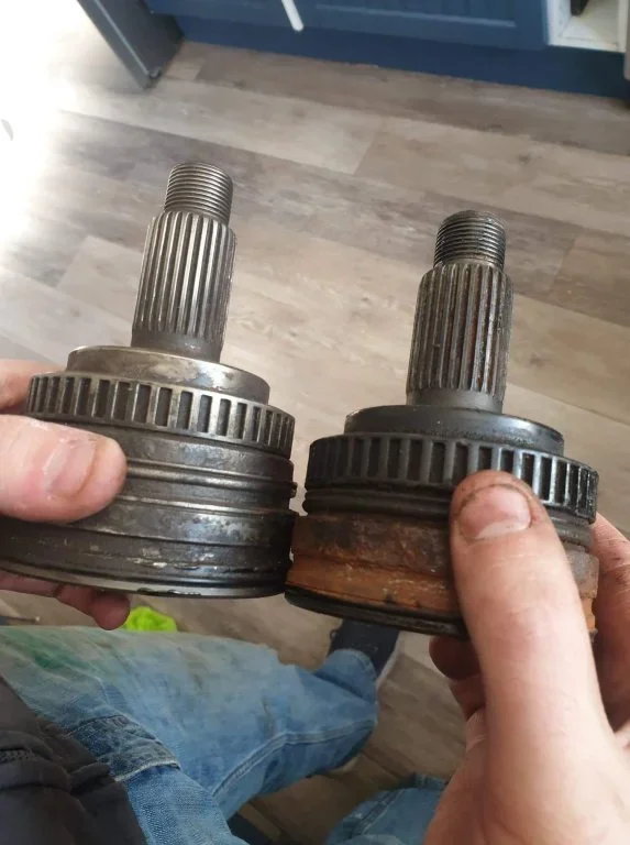

Also the dick that I am broke another rear drive shaft. Straight in first one. Took wrong cap off again.
Ruined. Doh! Drive shafts alone have cost me £260 in stupidity so far. Plus to add salt as you can see they are different (my original is left, replacement is right) , next replacements coming are getting a quick check and if ok they getting cleaned up and slotted in. Fed up arseholing around breaking driveshafts 🤣 also for record. Wtf is that cap not a replaceable part? Surely someone somewhere knows where they can be sourced?

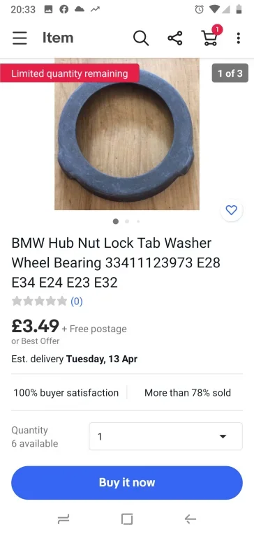

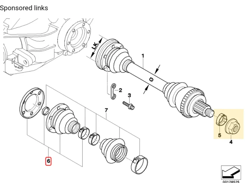

Anyone any of these knocking about no 5 (33411124945) cheapest I can lay my hand on is eBay at 11.79 which is ridiculous for a washer.
Would this fit?

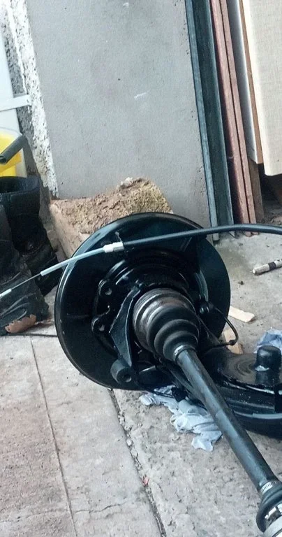

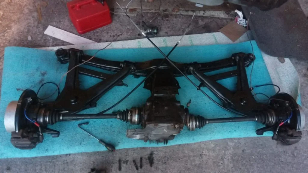

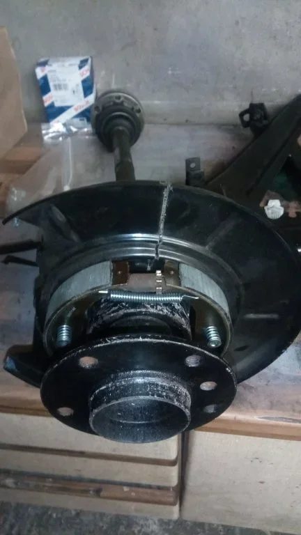

OK so. The rear subframe fun continues with more of my inherited irish stupiditity. *Disclaimer: mechanic who pushed the hub in also didnt spot this booboo either*
Was sitting after id got the handbrake shoes all made up. discs on. all set out nicely on the floor admiring the near closing point of a long journey. Standing with a caliper in my hand ready to put into the brake disc when i see it...... (handbrake cable there just to keep out of road)
Heart sinks. Called mechanic - whole things going to need pressed out (will probably burst the bearings) hes flat out for next 3 weeks. have another guy i use, his press is banjoed. left me with no option.....
I must admit I'm not pleased with myself for doing it. however at the same time, I'm not sorry for doing it either. I wasn't going to wait another potentially 3 weeks to get this rebuilt again. Clocks ticking and I want some summer fun in it before the Irish weather comes through.
So here we are.. I've a later picture of it built and bolted but the camera has a shocking flash so looks like crap. will get a better one this evening to update.

Success!
3hrs later it's up and in.
Need to tidy cabling and brake lines etc and sort the handbrakes out but my god am I pleased with myself. Diff needs a we clean down. Been sitting gathering dust for about 5-6 months lol

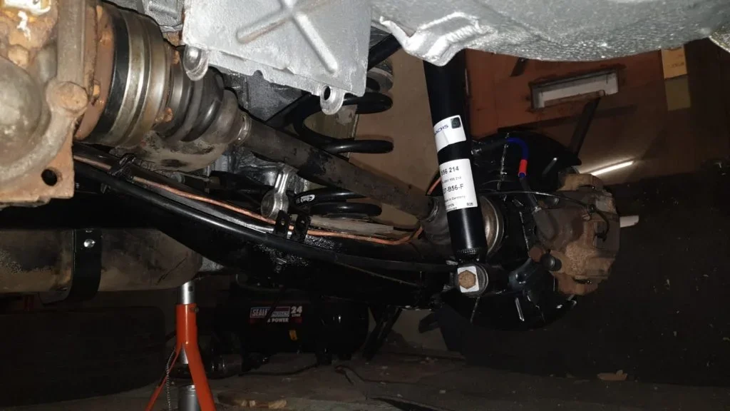

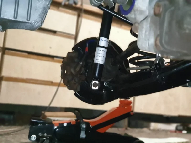

Got the brake lines done and the rear sub all tightened up. Had a bit of issue with one of the brake lines. Had to repipe and reflare but all good now.

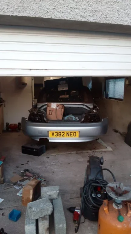

Got the rear bumper back on and lights in.
Lovely seeing that booty back again.

Brake pipe run doesn't look quite right if you don't mind me saying. Great read. Did you tighten swinging arm bush bolts with the cars weight on the suspension, will twist and tear bushes otherwise. Will look great when panels on.
Nah in the pics the brake pipes are just sitting - not in final resting place. i tightened them but not full tight. just good hand tight.
