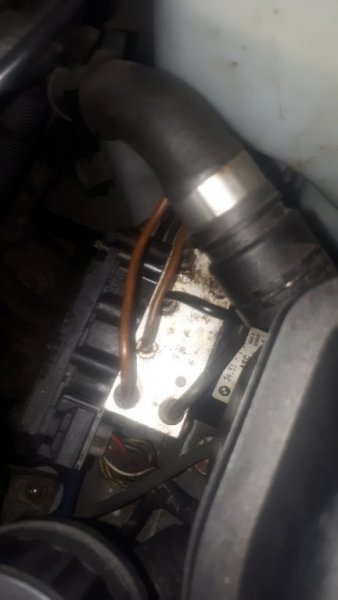

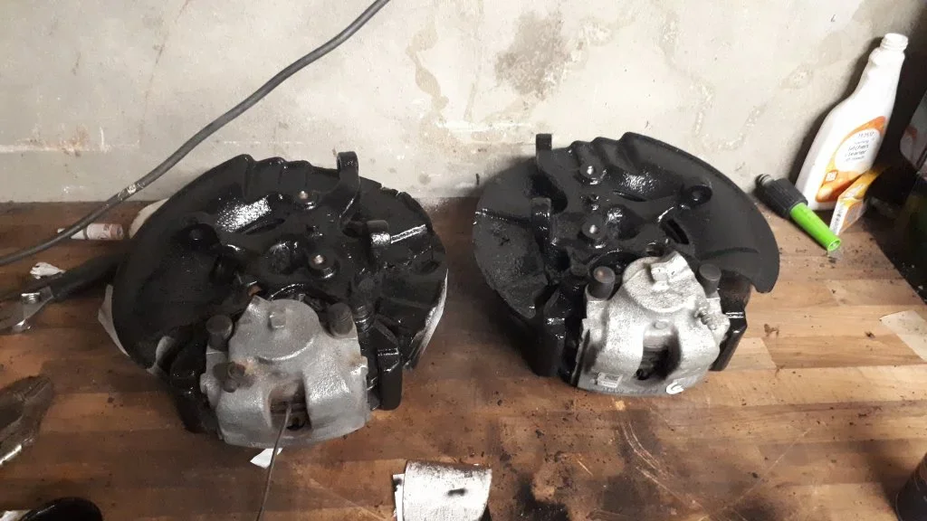

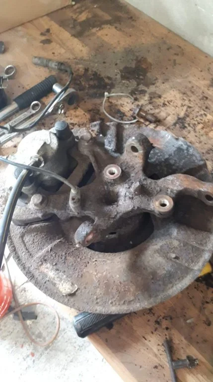

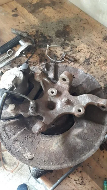

Took into taking the struts off today. Abs sensor siezed solid. One abs sensor snapped and the bolt in the other snapped so that was also fun and adds to more fun later. The caliper mount/bracket will just not budge so gonna drop them down to mechanic down the road to dismantle and do the abs work while he has them. Cleaned the rust off them anyway so will give them a spray in heat proof paint and get a new guard ordered for them.

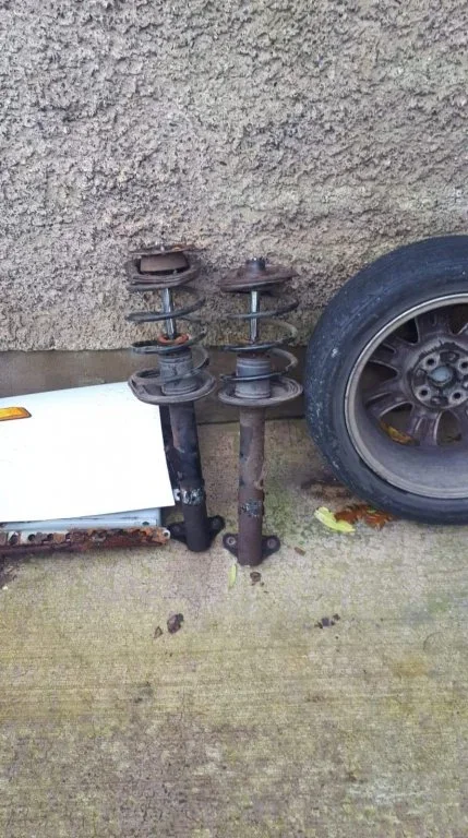

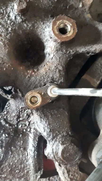

Had a free hour this evening so started trying to take one of the abs sensors out. Siezed solid. So got the drill to it and gradually wore it down till i could remove it
Had indended on swapping out the cover, replacing calipers and disks etc too but decided they werent in too bad of shape. Car passed MOT not 2 months prior to me buying it so they cant be too bad. Can always replace once on the car in future.
Im trying to keep costs down a bit this month as just after buying a set of eibach 30mm lowering springs and a full set of sach shocks, these few purchases will finish the front half and can start thinking about exhaust system (which needs bored - mechanic job) and working on dropping out the rear next

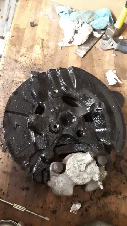

ive cleaned one up best i could and hit the whole thing with some hammerite black spray id purchased previously.
Thats one prepped and ready for when the shocks arrive.

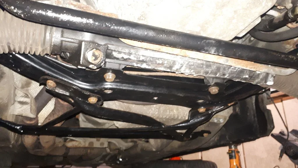

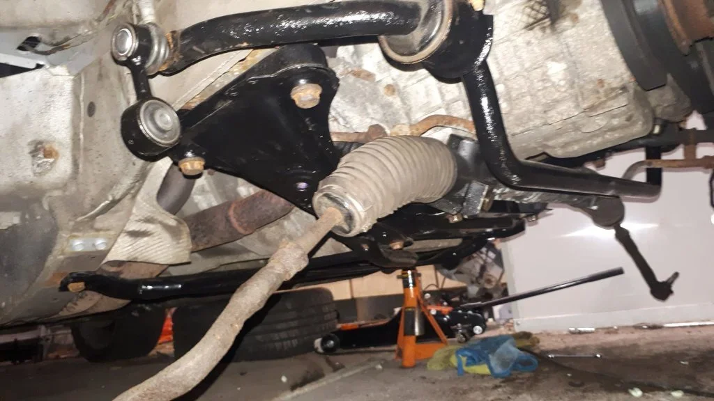

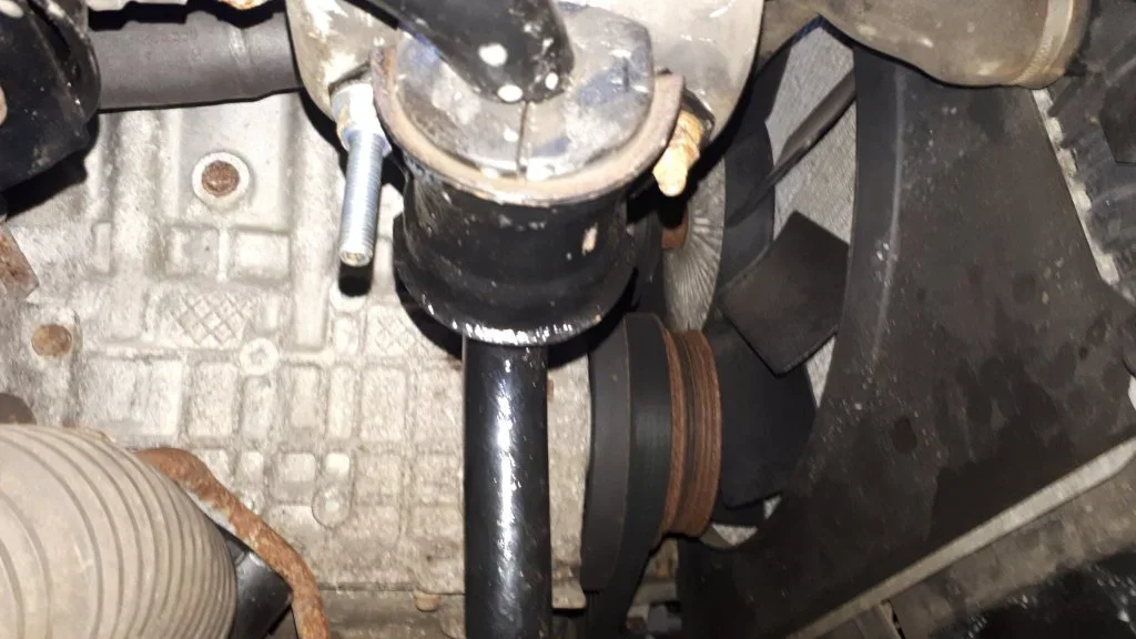

Stuck into starting to put things back together again. Ran into a minor setback where in the rollbar(?) Bolt snapped as i was tightening the last nut on *doh* so going to have to bore it out and tap it and screw a bolt in instead. Not the end of the world just another few additions to the swear jar!
That being said i cracked on anyway and got the cross member back in.
Started cleaning the wheel arches for getting them ready for the wax oil treatment and going to drop some paint onto the steerjng rack and a few other spots to shine them up again. Nice to see new pieces going in though. Starting to pull together.

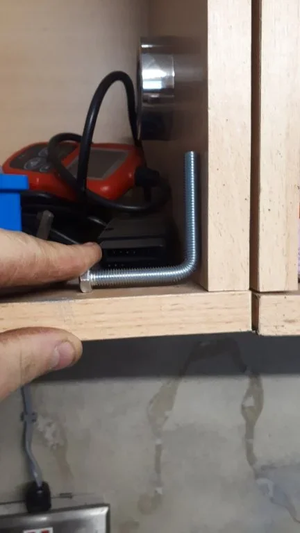

Thanks to tony and his agricultural background we got a cheap and effective solution to the snapped stud issue.
Cut the bolt at the base. Bored it out to 8.5mm. Gradually worked from 2.5-8.5mm.
Went to local hardware shop. Grabbed a few bolts and locknuts (m8 and m10) hammered the m8 to 90degrees cut it to approx required length and fed up into hole. Great we fix.

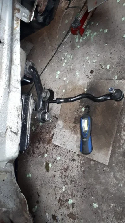

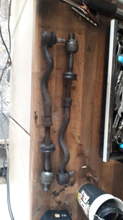

Also removed the old tie rods and fitted new ones today. So much stiffer than the old ones. Gonna be sweet when shes back on the road.

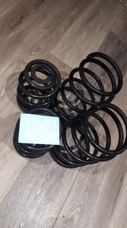

Eibach lowering Springs arrived from @Lee yesterday. Very pleased with them. Like how he slipped in a we sticker with them. We sneaky advert roaming about n.ire :whistle:

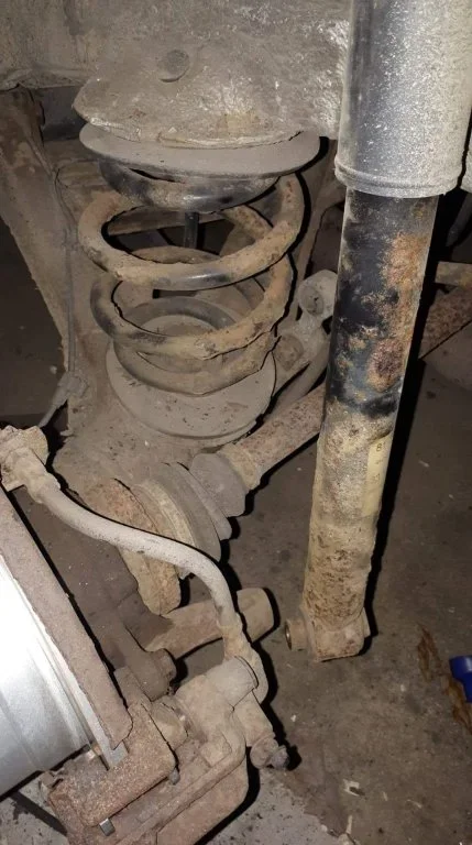

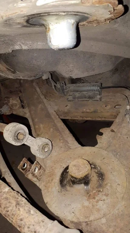

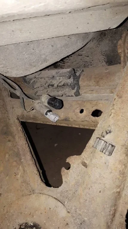

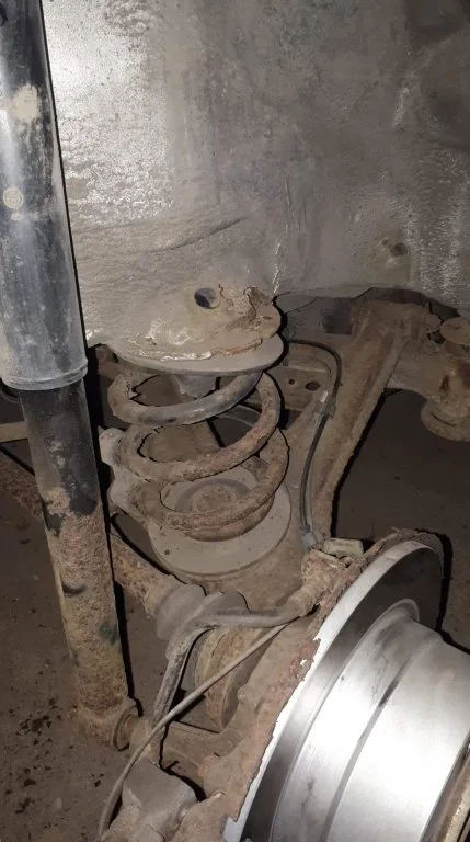

We bit of progress this evening. Lee once again holding my hand as i go.
This is everything still attached. Minus wheel and arches. Both sides are much the same

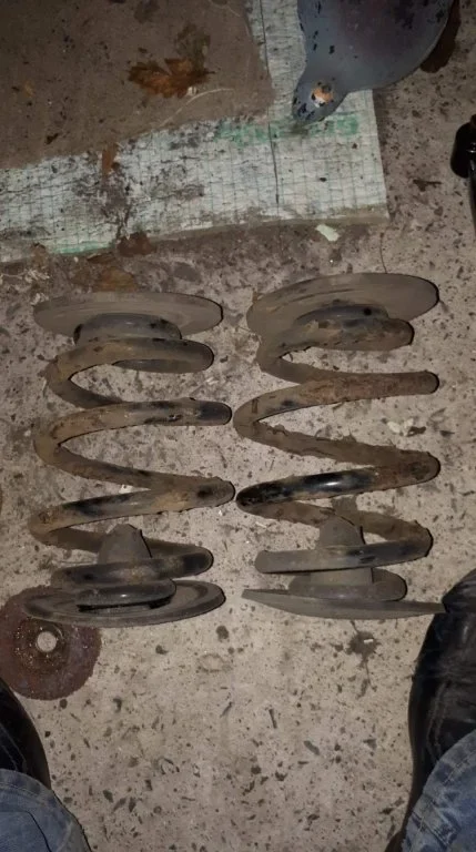

Shocks disconnected and springs removed.
received_2520369371594559.jpegreceived_182782850114722.jpegreceived_1313227382372486.jpegreceived_686843102239871.jpeg
All are absolutely done but new ones on route and have new springs ready to install.
Couldnt help but think of this gif while i was looking at everything and there sits two new break disks
On the plus. Apart from the we hole on the driverside trail arm cross bar(?) They might actually sandblast and powdercoat up the best. Still not 100% convinced but they seem solid enough. Clean stinkin granted but a wire brush will take the rough off them.
Will look at doing the rest of the removal next few days.
It will get better. Ive every faith.....

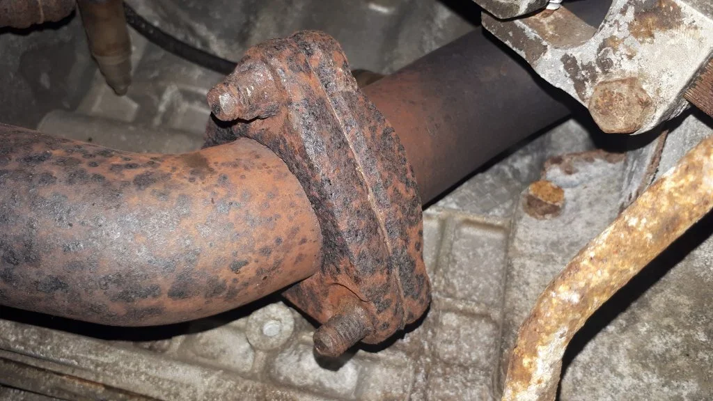

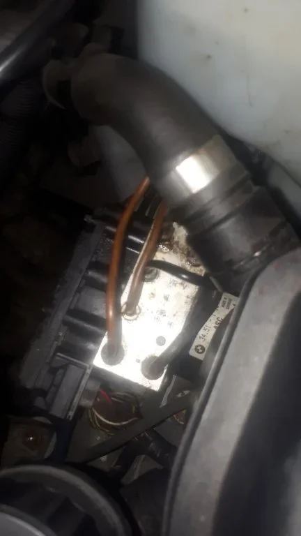

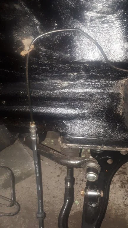

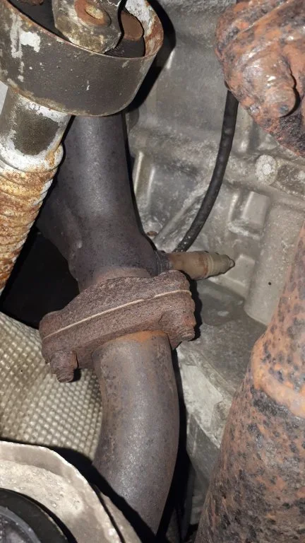

So ive reached the point where i need to remove the exhaust. Im at a bit of bother where the nuts are frozen and disentrated to a point where one genuinely doesnt exist. Im hoping with a bit of patience and ignorance i can get them freed off without breaking anything, cutting anything or having to bore the studs out.
While i have those soaking in pb blaster (not sure if will help or not but willjng to try) i got a delivery today of break pipes. Got the passenger one installed (not properly tidied up but its in!)
The drivers side is going to be a bit more of a struggle.
Anyone removed the drivers side abs pipe and successfully installed? Looks like could be quite an awkward we boyo to fit and bend properly with engine etc in the way

Instead of replacing the whole line you could just replace the corroded section as it does look tricky not done myself but patience is a virtue they say whoever said it though needs crucifying.
With the exhaust can you angle grind/trimming the nuts off on the visible two? Or have room to use some heat and a impact wrench to do all three? Hope you can get them off without having to resort to fixing snapped studs. Why nuts and bolts couldn’t have been used in that are would have been easier to sort out.
RE Break lines: Its not even corroded. the nuts are seized and damaged at the breakpipe connection. Tried a breakline spanner but wasn't enough to grip too, whoever done them prior used standard spanner and left them damaged for future persons problem (yey me!)
The drivers side one might be worth learning how to flare a breakline end because a quick pass last night looks like it will be a absolute job to remove and install new.
As for the exhaust. the grinding is what im going to attempt to do. If I can get the loan of an impact gun i will also try it. as for access im not 100% sure the gun will fit (could always drop the front sub out again to give more room but if can avoid all the better)

2nd thought after watching videos on how to flare a breakline. im going to cut and flare the breaklinke =))
The Legend
Deceased
When you have a rounded brake pipe tube nut use FLAT jawed mole grips. Do not use curved jaw ones, they don’t work. I have never failed to get one out using this method to loosen it.
