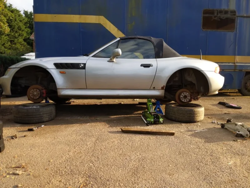

After selling my old very rusty Z3, I went and got another.
It's 98 1.9 M44 and upon first glance looks pretty crap, which is fine because it was very cheap!
Job 1
So the plan is to tackle the sills first. Take off the outer sills, decide what to do with them later, then clear all the rust off the inner sills and see if I've made a financial mistake.

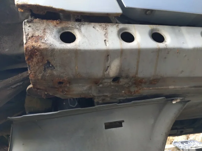

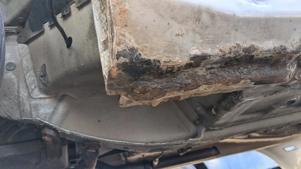

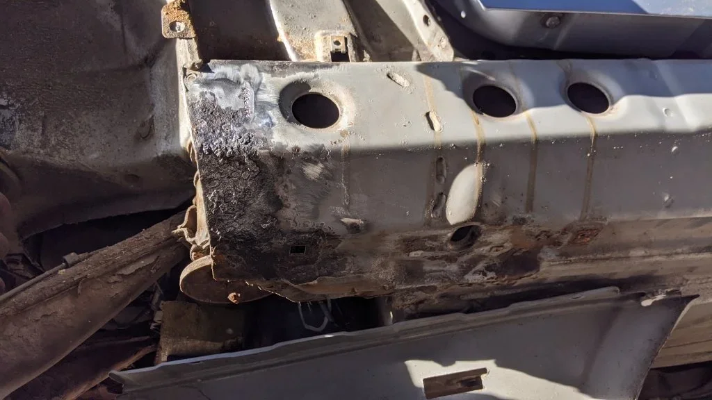

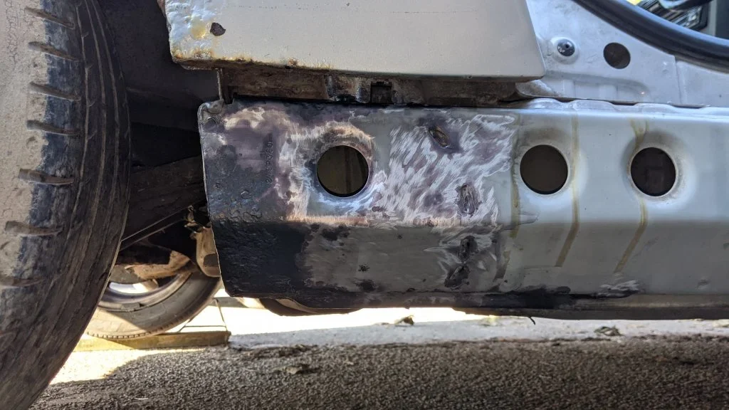

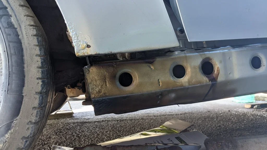

Inner sills look like this-
Passenger side front:
Jacking point:

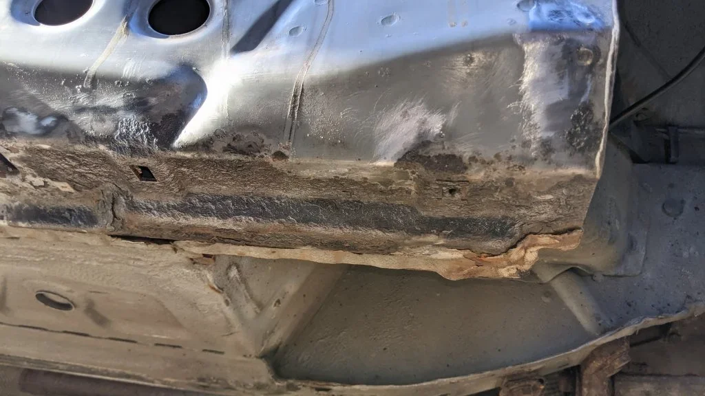

Rear:

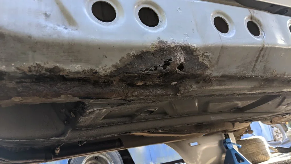

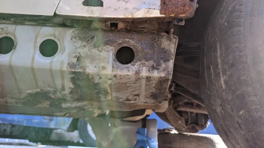

Driver's side-
Front: PXL_20210921_155946462.webp
Rear:
So the plan is to treat all the areas but not to put the protective agent on the passenger side sills. I'll probably go over the areas with some black paint to seal everything once it's treated and then get the jacking point cut out and welded. Wax and welding don't go well together, so I've heard...
Of course with sills no one would know the holes were there but they are and it needs fixing. Again, if it's welded and the sills are on, no one will no either so all good.
Only need it to pass it's MOT until I can get a trailer. Time to crack on!

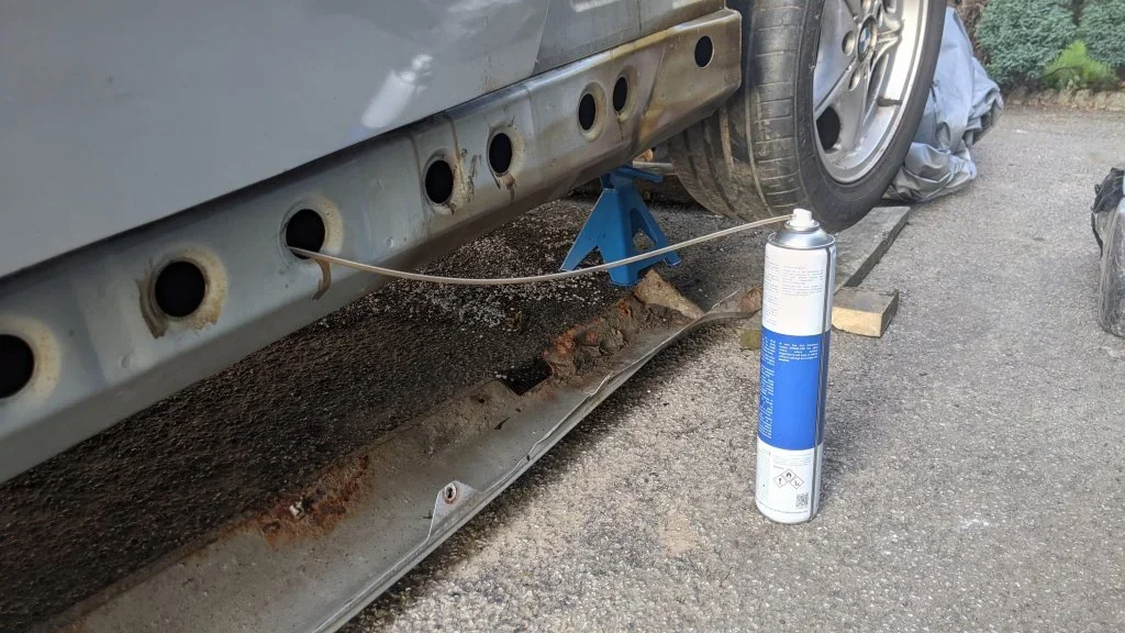

Onto treating with the Bilt Hammer Hydrate 80.
First coat went left to right, waited about 20 mins and then did a second coat going top to bottom, as per instructions.
Bottle says to wait 24 hours or 3 hours and protection won't be any less. Unfortunately I don't think I have enough hours of daylight today to get the primer on, so that'll be first thing tomorrow and later in the day the Dynax S50 cavity wax

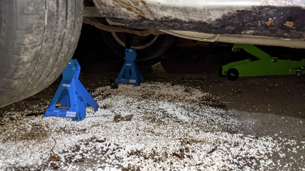

Next was oil. The first time I've done every step by myself! After getting the car up in a way that I was happy it wouldn't fall on me...
Had to remove the airbox to get the oil filter tool on with a rachet. It was a crap one from Halfords that doesn't rise up for the ratchet head. So extenders wouldn't fit.
All went well after that. Kind of.
In the now infamous words, shouted out by @Grumps at Zedshed Midlands...
"It missed"
Good thing we've got a full bag of kitty litter 😭

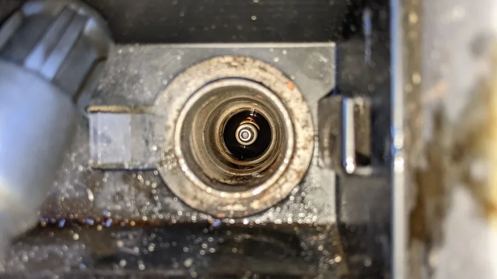

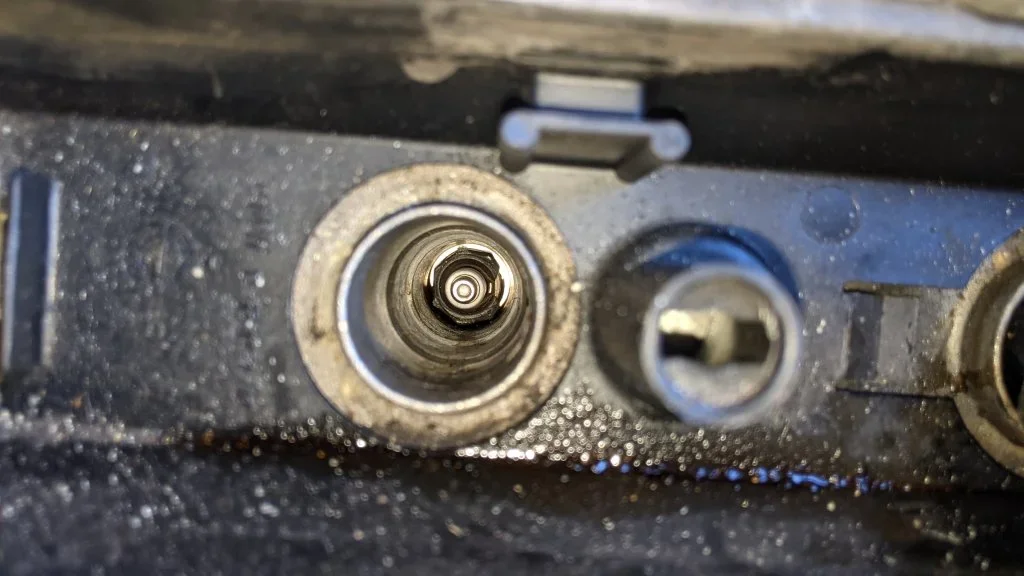

Had an interesting problem with spark plug 2. It seems to have something hexagonal sat on top of the 10mm nut:

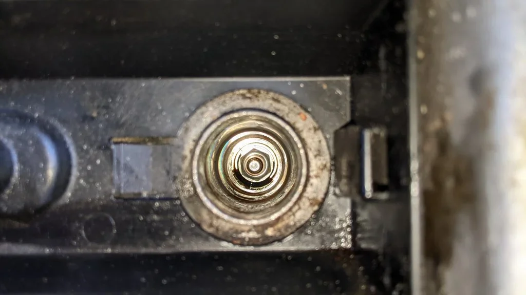

For reference, this is what all 3 other plugs looked like (all new now)
Need to get some needle nose pliers long enough to try and grab it. Other than that, servicing is done!
