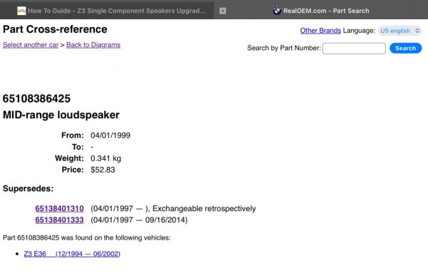

Look forward to seeing how this goes - I have the same system and have this job high on the list.
In the diagram, isn’t it showing only 1 speaker behind the seats? With no wires?!
For some reason I can not explain it shows no wiring. This is the midrange speaker same for all setups and I am sure that there are two of them. Will be 100% positive when I check.

Zephyr
Aug 10, 2022
136
Ok. First let me say that I have read multiple horror stories and some successful ones about Z speakers.
Most people complain about horrible results and this puzzled me.
so, my first approach was to understand the problem.
we have three kinds of speakers, one head unit and a strange looking device that we suppose is an amp. Why did BMW put all these together (are they dumb?) and why do people complain that when they replace them the sound is worse?

Zephyr
Aug 10, 2022
136
I can not upload a better quality wiring diagram.
will try later but working on a virtual machine within a vdi does not help at all. Sorry.
Zephyr
Aug 10, 2022
136
Our car is a 97 1.9 & didn't have the rear speakers in nor any wiring for them that we could see. If we put our details into real oem we get the same diagram but with 10 & 11 greyed out & no info, this may go some way to explaining the lack of wiring etc. on the diagram.
Found it.
your model seems to be even simpler than mine, the diagram states that you have a high range and a mid range speaker at each side and thats it.
It also shows the “amp” we are talking about. Can you verify that the “amp” is there?
if there is one there, we can check the part number and see if there is a non crossover amp (yours) and crossover sub one. (Mine).
if its the same part number then I will have to dig deeper on what this device actually does.
(makes no sense to have a low crossover connected to a midrange, unless it is not low range and it acts as high pass one).
even more confused now.
