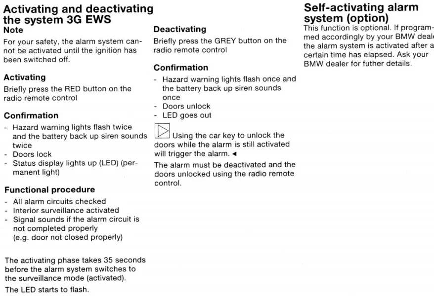

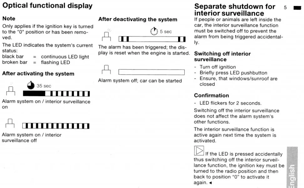

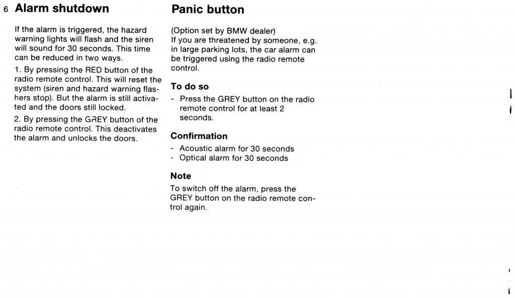

Hello,
As Geoff has said the alarm is set with the remote - the key just centrally locks the car. Can you confirm you have a 3G EWS system fitted ? It could be an aftermarket.
As far as I know there are no alarms when you remove the key. If the system is set (via remote Fob) and you use the key in the lock then that triggers an alarm.
The following are extracts from 3G EWS supplementary manual
Page 4 - Activating-deactivating.jpg Page 5 - Optical Functional display.jpg Page  6 - Alarm shutdown & panic button.jpg

View attachment 120027 View attachment 120029 View attachment 120031
It is the BMW car alarm fitted. I don;t have a key fob.
