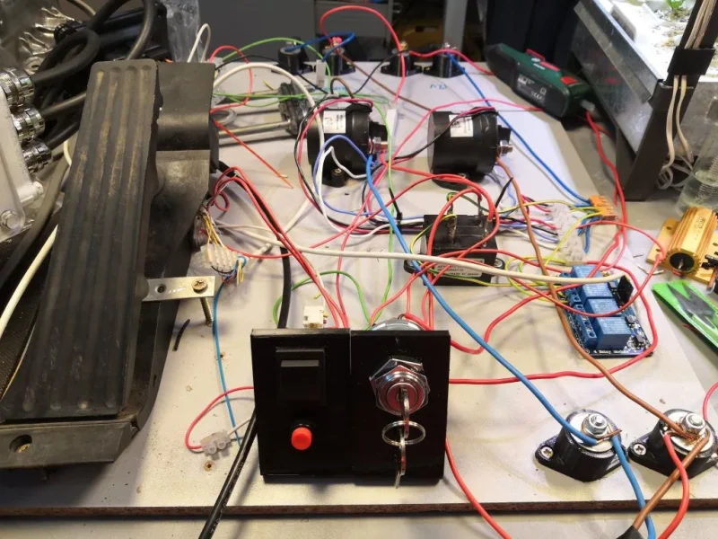

A test board with all the high voltage components (contactors, pre-charge relay etc) and the control elements (throttle, keyswitch, button to represent brakes) is mostly wired up - should get that finished today assuming some more nuts turn up for the HV connections (though it's only getting ~28V at the moment). And then be able to start testing the electric motor. Photo below if you're interested - the washing machine heating element is being used as a current limiting resistor for testing btw and won't be part of the final thing!

In the meantime, I have all the HV circuit running beautifully. Before the DC measurement started floating, I could turn the keyswitch and the pre-charge relay would take the capacitors in the inverter up to voltage. Then when I turned to the start position, the main contactor would drop in, giving it the full juice.
Forward and reverse, throttle and brake sensors all also working on the test rig. So when the control board comes back from repair, I should be straight into testing. Pic below is a bit of a mess, partly because it's taken after I tore down the inverter again in frustration. But it all works.

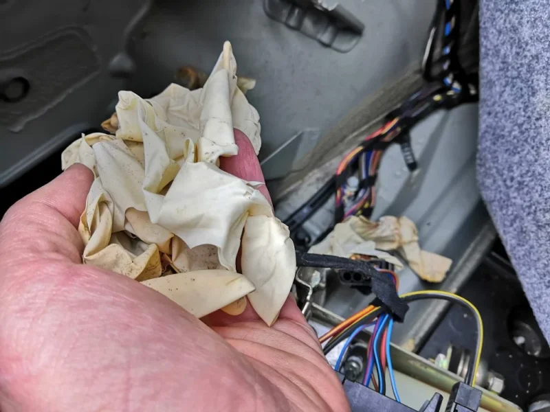

This clicked when the switch was pushed and even shuddered slightly, but didn't move. I popped the hood down and unbolted the seat per the instructions on here, then flipped the seat over. It was precisely as disgusting as you would expect for a 21yo car.
Once I worked out how the mechanism worked, I popped the pivot pin out of the end of the retainer into which the threaded rod slides for the tilt mechanism. But even when I lifted the forks away from the frame it wouldn't turn by hand. I stuck an adjustable spanner around it and gave it a gentle twist and slowly it started to come around.
What I found in the (open) other side was that a penny had fallen in and become wedged under the end of the screw. This was in turn gummed in with what looked like some melted sweets.
A bit of cleaning and levering later and one very deformed penny came out. I put it all back together with some fresh grease and sure enough, the tilt now works fine.
Pic below is after I had scraped a lot of the gunk away...
