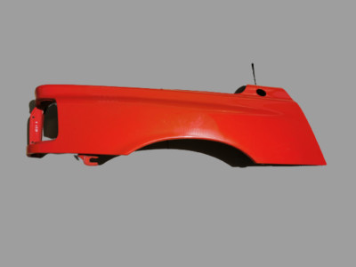

Hi all, I'm trying to source some replacement front wings for my Z1 but not having any luck. I'm in the UK, have tried BMW Classic and all the various euro part, aurodoc, etc. but nowhere seems to have any stock. Could anyone help me please?
backseateducation
Dec 30, 2021
119
Par, Cornwall
Hi Ian, I don't wish to sound like a stalker but is this the red car currently at KJ Rule bodyshop in Cornwall?
I haven't been on this forum for some time since the demise of my Z3 but over the last couple of years I've been looking after the Cornwall area of the BMW Car Club - one of my members alerted me to the car after he picked his own vehicle up. I've had a bit of an ask around including to a member of this forum I know through the club, plus our Z1 Register and there seems to be no real option other than repair. There was talk of carbon fibre replicas being made in Germany but I can find no more info. The last person I knew to own one had the wings repaired by Autostyl in Chacewater but I don't expect they can do anything more than KJ Rule can.
I will send Simon at Rule's an email this weekend telling him what I have found out - I had to go to our depot next door (I work for Imerys) so have seen the car myself. I'll keep digging! hope you don't mind me posting a photo.
Matt:)
Ian W
Jan 3, 2023
6
Ha ha, not stalkerish at all. Yes, that's my poorly zed and no problem over a picture - first time I've seen her without her clothes on!:oops: :) Thank you so much for taking up the quest, I too have been trying the various routes advised by others and had also heard the carbon fibre rumours but am also lacking in actually finding any panels - even trawling the German and European websites.
In case of interest to another BMW aficionado, as you can see my Z1 has been converted to right hand drive but also was one of a very select few that was converted by Griffin Motorsport (now defunct I think), so rather than the standard 2.5ltr from the 325, it has been bored out to a 2.7ltr and has various other tweaks to give it a little more performance in line with what the very capable chassis can handle. Anyhow, I digress!
Being in Falmouth, there are a number of very skilled boat builders/repairers here and as a last ditch resort, a friend is having a word with his 'composite guys' to see whether they could make a mould off the existing wing and then create a new glass fibre panel. Having said that, I am surprised that KJRule have said that one of the wings is irreparable because following chats with other Z1 owners, they appear to have had worse splits and have managed to repair them with plastic welding? KJRule have advised that they have they right equipment for plastic welding but there was a lot of fizzing and bubbling and they were worried the panel would distort (....or perhaps has and hence is now irreparable?!) KJRule were recommended to me and indeed had the car in just over a year ago to repair a split and that's why it's back with them as the repair hasn't lasted very well.....having said that, on the plus side, their painting and colour matching was absolutely perfect! Perhaps, it's worth me talking to Autostyl, in case they have more experience with this polycarbonate material...?

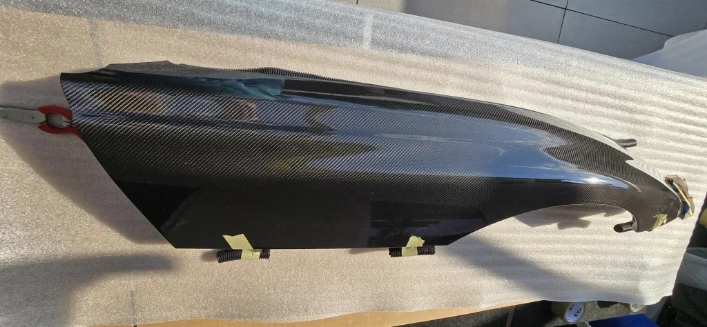

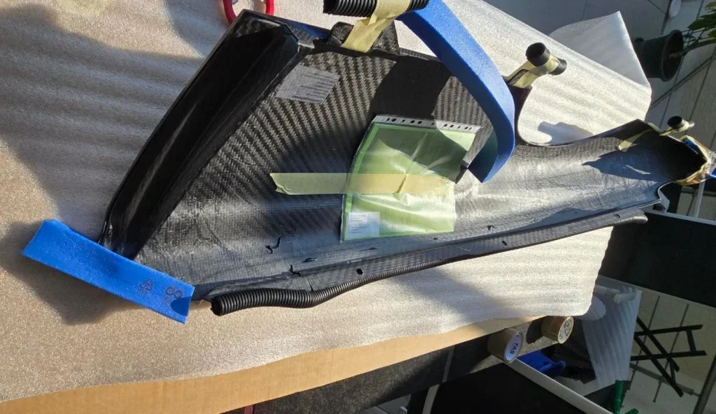

Just by way of an update for those interested:
I contacted all those ideas that were put forward plus seeing if I could convince some Superyacht composite specialists working at Port Pendennis Shipyard in Falmouth UK, to use my original wings as a mould. Unfortunately, every avenue came to a dead-end apart from one! Edeldesign Tuning in Germany had one pair of carbon wings in stock. So, long story short, I'm now feeling very poor whilst they are being packaged for delivery to the UK...... I also now need to work out how to justify this expenditure to the wife....... so has anyone tried sleeping in their Z1, asking for a friend?! :p;)
I'm sure those interested would like to know how much and I can't give a final figure yet as I'm still yet to find out how much VAT and duty will be. However, the price quoted to me from Edeldesign was 1,340 Euros for a single wing, not incl. german customs & insured delivery; or 2,730 Euros for the pair with all included. Naturally, I have no idea if this was a standard price (even if they had to make the wings from scratch,) or was a special price as they were in stock. So far, I can report their communication has been exemplary and they're updating on every step of the process.
Although I intend to get these painted, that first picture did make me think (if money was no object), how cool would a total carbon Z1 look...?:cool:
