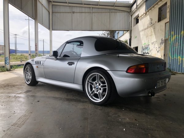

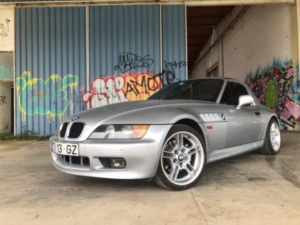

found a set of m66 bmw wheels that came off the E39 series
17x8 235 45 17 front
17x9 255 40 17 rear
17x9 255 40 17 rear

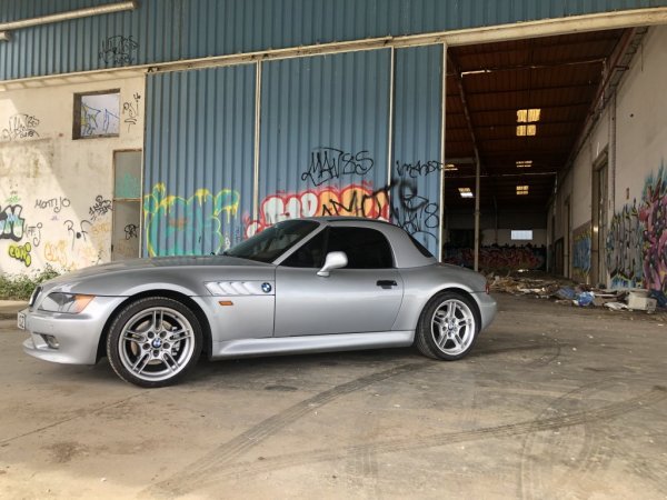

CRAP!! I liked these wheels and I really want that dished out back wheel wider look like the M.This is a link to the style 66 wheels
http://www.bmwstylewheels.com/bmw/66

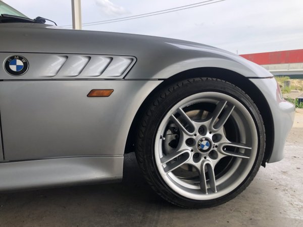

Looks as if they are ET 20 so will probably stick out too far from the arches also E39 wheels have a larger centre hole in the wheels and will need a spigot ring to make them fit on the Z3 hubs.
This link shows how the different offsets ET affect the wheels position.
https://www.willtheyfit.com

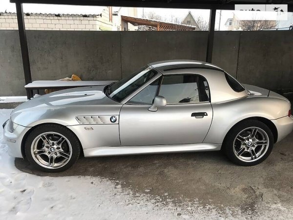

I did a poor photoshop once as I really like that wheel and they quite cheap to buy used

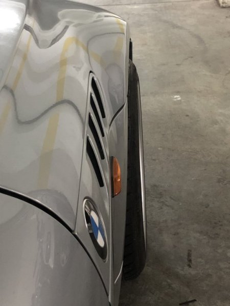

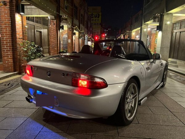

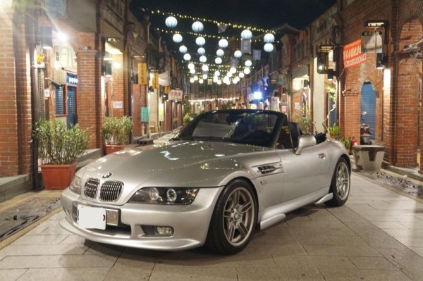

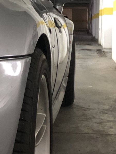

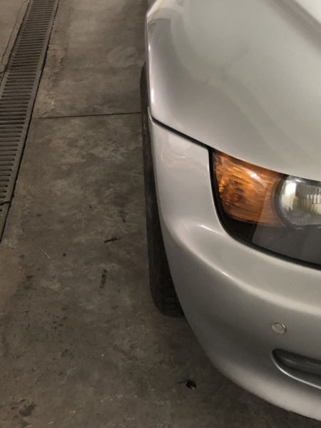

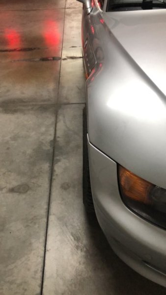

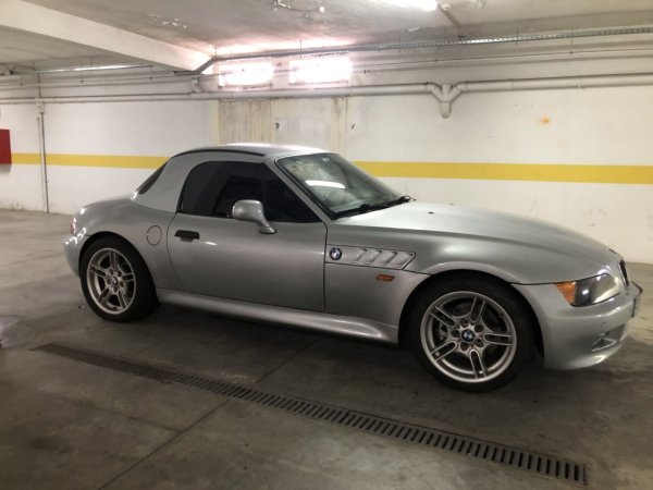

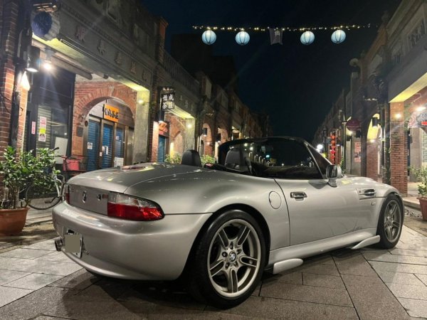

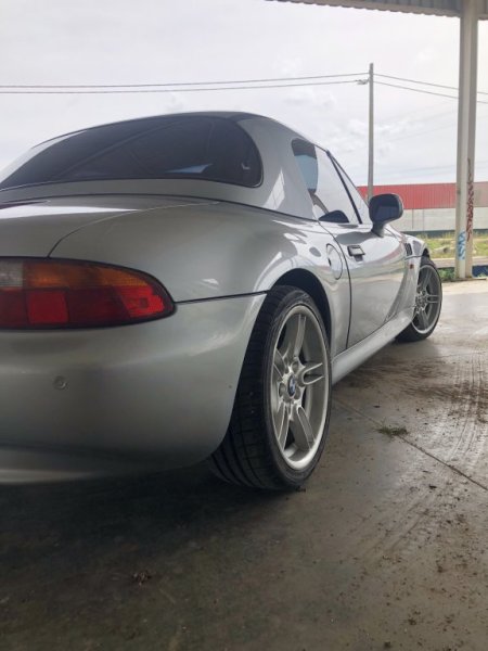

Im not certain of my offsets, I bought the car this way. But I was told these were custom built at a very well chosen offset at some eye watering expense ..I put the originals back on for a day, since I had those too...and nope...too vague on the road, albeit more comfortable. Each to their own I guess.. Sorry I cant be more helpful, but it gives you an idea of what you can get away with.. I can tell you though that they are 9x20 front and 10x20 rear...Offsets as I said, uncertain...20 is too much for me and my problem is getting out of the car. What are the inches of width and offset?? I would prefer not to cut anything from the plastic
View attachment 293771Same pics from web
Would you even notice if you had a puncture?Oh and yer stuffed if you ever get a flat..
 30s are pretty damn low, even round here where the roads are better than many I've seen over in Ingerland I wouldn't fancy going that low.
30s are pretty damn low, even round here where the roads are better than many I've seen over in Ingerland I wouldn't fancy going that low.Yeah I hear what your saying, the roads around here are very ordinary after cyclone Jasper. I,m scared of doing in a rim, a one off replacement would be costly for sure...But I like the way handles, Ill live with it...Would you even notice if you had a puncture?30s are pretty damn low, even round here where the roads are better than many I've seen over in Ingerland I wouldn't fancy going that low.
