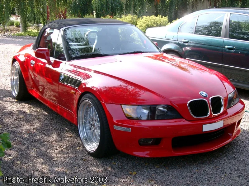

@Based Pony - Don't know what has been used in this car to get the stance but it will provide an idea how the extended rears sit with a stretched tyre - albeit there is quite a stretch in this example - seems a bit overstretched!
