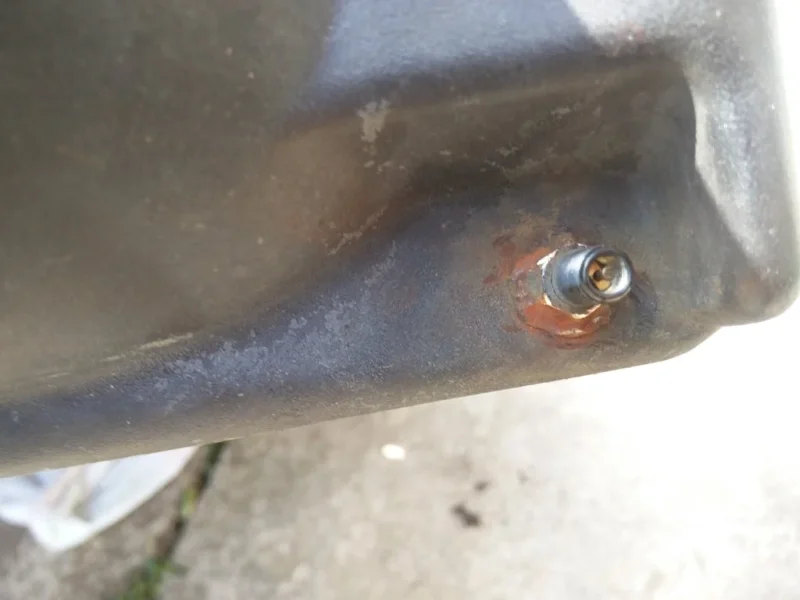

One issue I found was that the extension valve, which shows on the side of the wheel housing had seized, so I wasn't able to remove this - the wheel housing from the project allowed me to remove the extension valve - so I chose to restore that housing instead.

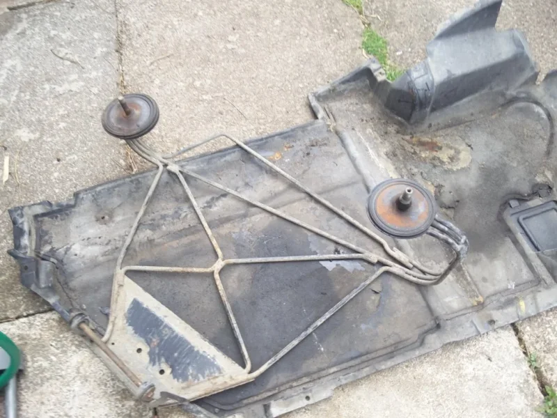

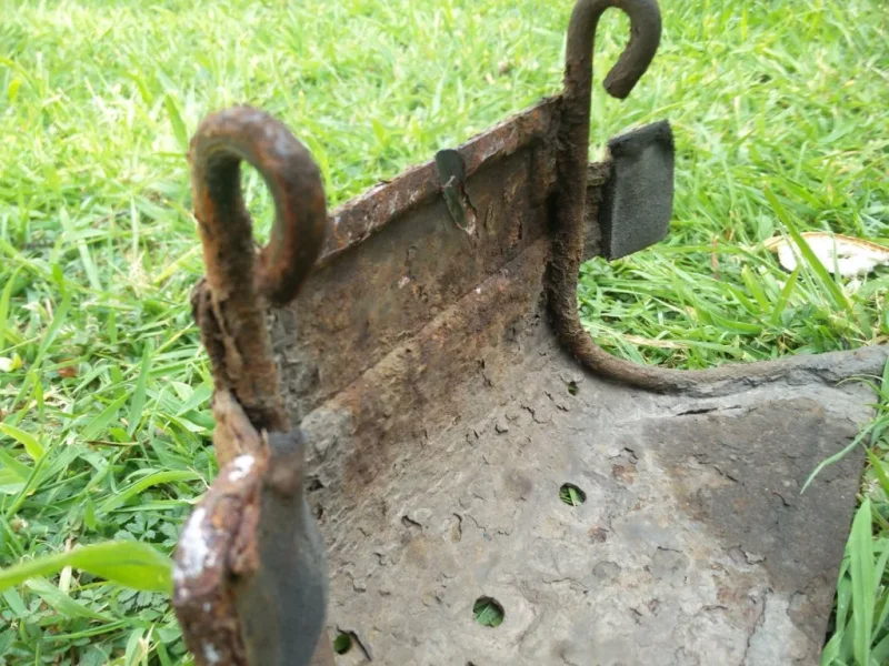

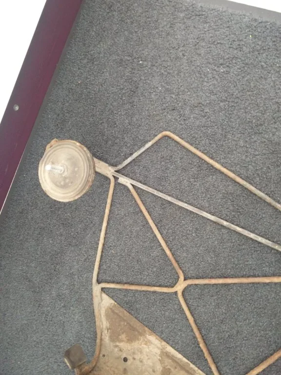

Here is what I had to work with:

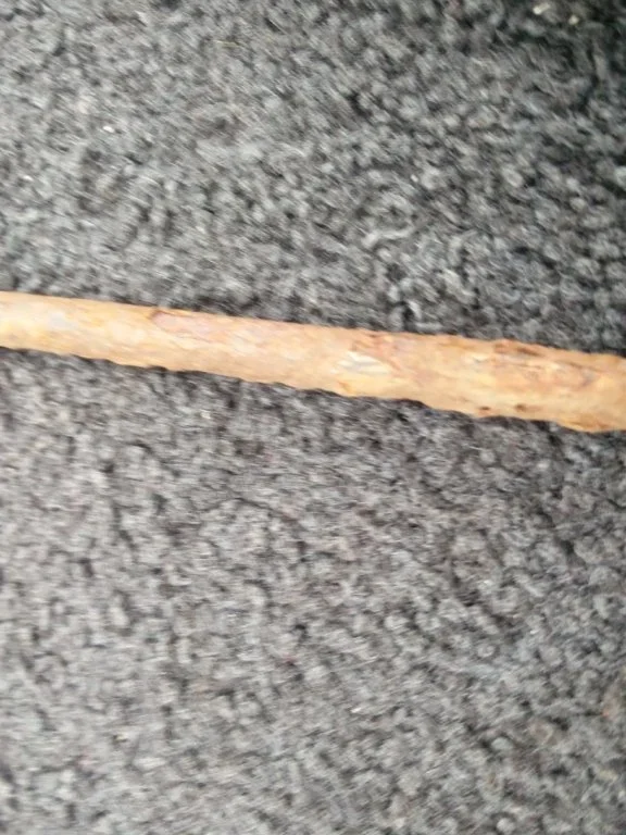

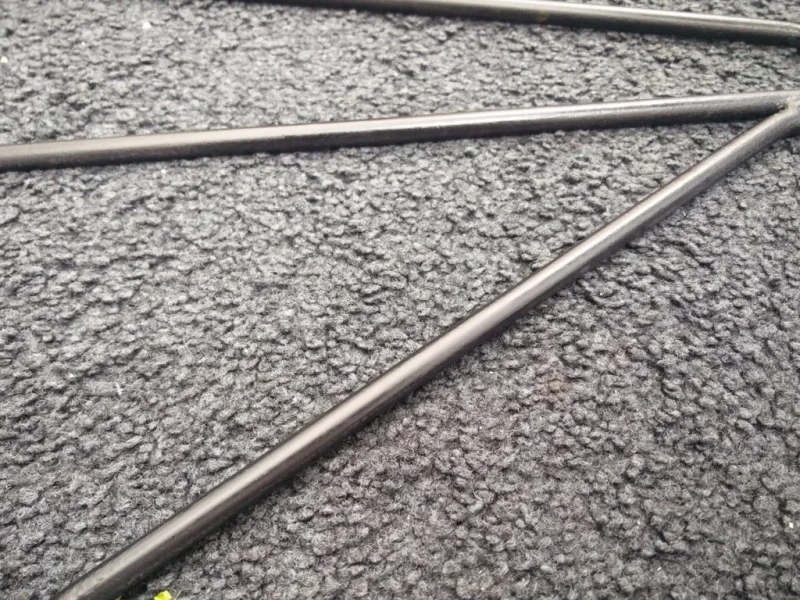

I started by giving the entire carrier a good scrub with some soapy water. I then followed by sanding the carrier down using a dremel with an 80 grit flap disc (I didn't have anything lower than this, else it would have been used). After about an hour of sanding the carrier looked a lot better - in some spots the corrosion was so extensive that I had to sand back right to bare metal. I then wiped the entire surface down a few times with rubbing alcohol.

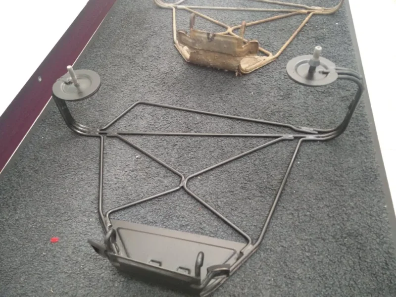

What I should have done at this point is apply some inhibitor - but this completely slipped my mind and I proceeded to apply a couple of light coats of primer followed by one heavy coat. I finished the night by applying a very light base coat of Satin Black.
Today I was up early and finished by applying two thicker coats of Satin Black .
Once this was done I put the carrier aside and let it dry - old vs new.

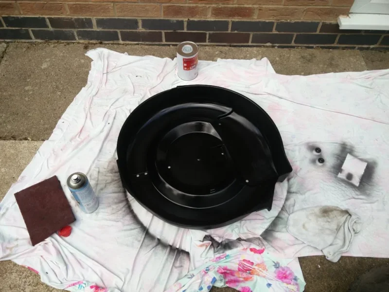

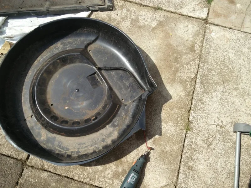

Next I started work on the wheel housing, whilst this wasn't covered in 'rust' there were rusty deposits and other scratch marks from the wheel as well as overspray marks from a previous respray - I wasn't happy about this, I gave it a thorough clean and then went at it with a scotch pad, finished this with a couple of coats of Satin Black.

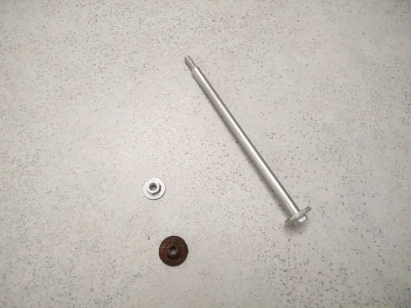

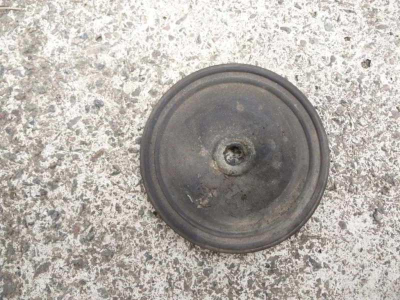

The bolt holding the carrier also needed attention as it had some rust on it - sanded down and painted the bolt. I understand that the proper way would be to plate it using something like black oxide, however, for my purposes, painting it will do just fine!

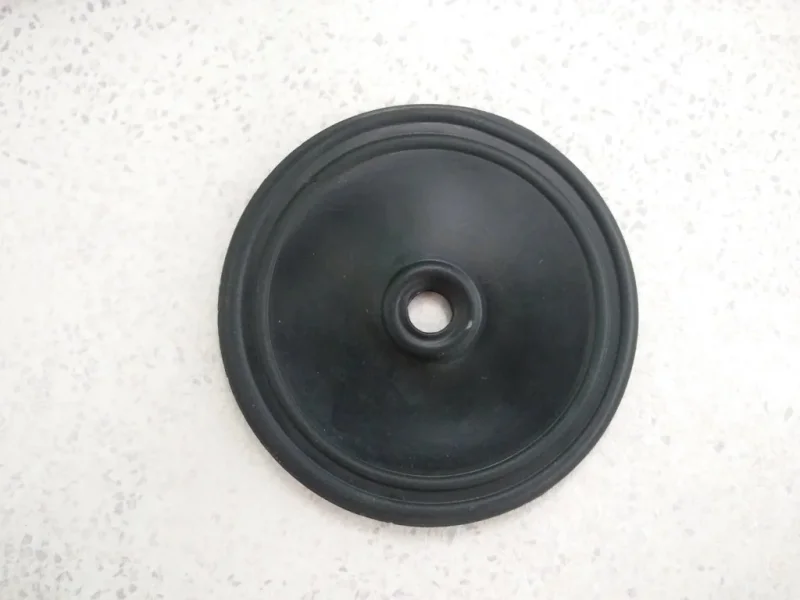

The rubber pads which act as a buffer between the carrier and body were also given a quick clean

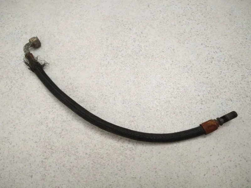

Does anyone know where I can find a new valve extension - this one is 300mm in length - don't know if BMW stock them?
I'm also after the rubber pads that keep the carrier from banging against the bodywork - not the ones that I show above - the ones I need are a sponge type.

Nice job!
The carriers are frequently rotted right out.
Did you spray the plastic tub with a plastic paint?
No I used satin black, previously, when I first got the car I sprayed it in satin black and the paint held up just fine so I decided to do the same to the inside.
Hey @Faheem, where did you buy the Tyre Valve Extension from, please?
