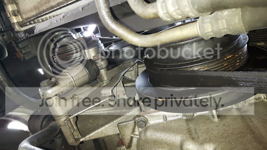

Hi Alan, these are a couple of pictures of Dave's old water pump from his 2.8 that we changed on Saturday. It is fitted the front of the block on 4 6mm studs which have 10mm nuts. Also you can see the large rubber "O" ring which seals the coolant in. You may have to gently lever it from side to side to ease it out of the block. This one had been replaced previously we think so was reasonably easy to remove. The "O" ring on the new one was a very good fit and required one person the push the pump in whilst another fitted the nuts onto the studs, the tighten the nuts evenly till its tight up to the block.

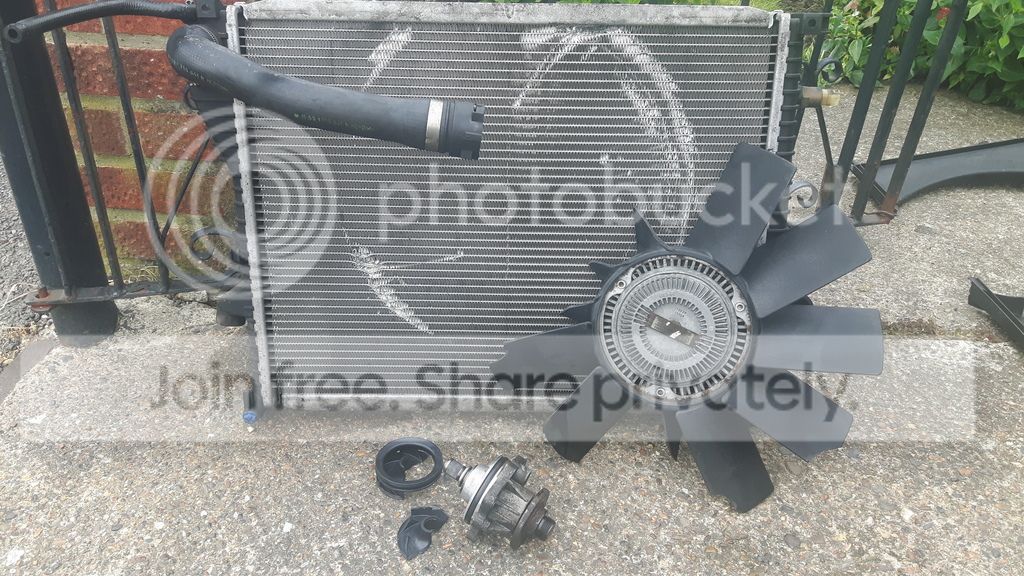

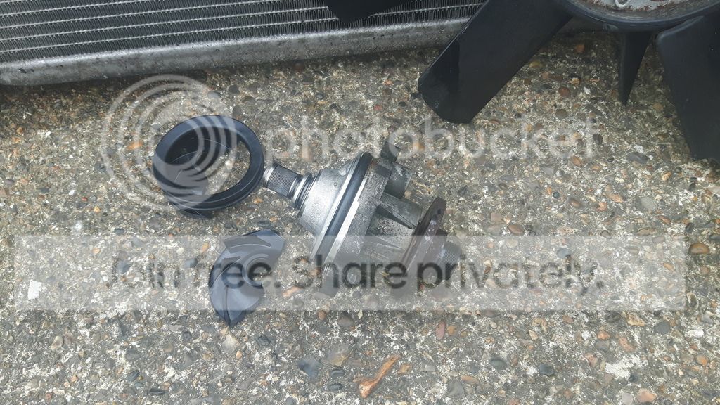

Okay for those of you not on Facebook.. so yesterday l started to dismantle the the car to see what nasty surprises were waiting for me.. well the bearing in the water pump certainly had collapsed big time and the shaft has bent causing the fan to self destruct and trash the fan and pulley and, unfortunately, the radiator.. The plastic pump impellor had also broken in two which is why l am getting an upgraded pump from Germany with a heavier duty bearing and a metal impellor!
Also noticed that both belts are showing signs of wear and one of the tensioner has some play so l'm going to renew those too..

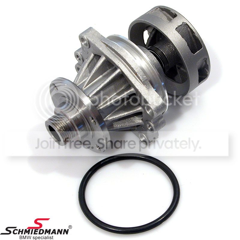

This is the uprated pump that lm getting fton germany which at £28.99 plus shipping ironically works out cheaper than a standard original oem one from a dealer??

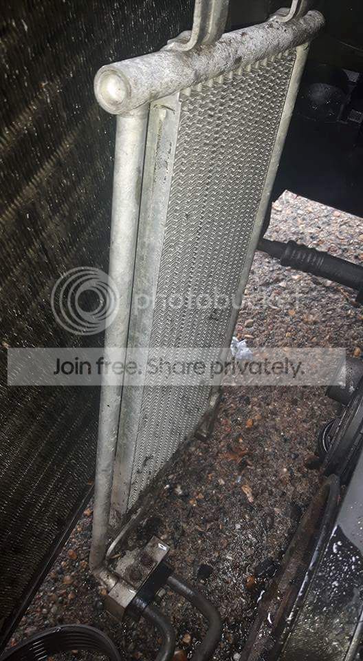

Whilst changing the water pump and other bits on my car is proving relatively straightforward, getting the radiator out wasn't because being a 2.8 auto there is a second small rad bolted to the front of the main rad which cools the auto box fluid.. there are two bolts at the top which are easy peasy but one of the two bottom ones is a pig and will be even more of a pig to put back.. it would have been far easier to have disconnected the pipes at the bottom but was concerned about losing the fluid unless someone can give me a top tip workaround?
If you can quickly plug the pipes as you remove them and tie them up as high as possible then you should lose very little ATF Alan.
