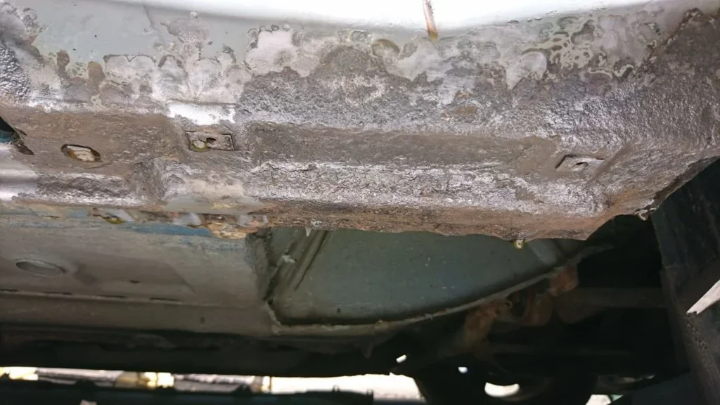

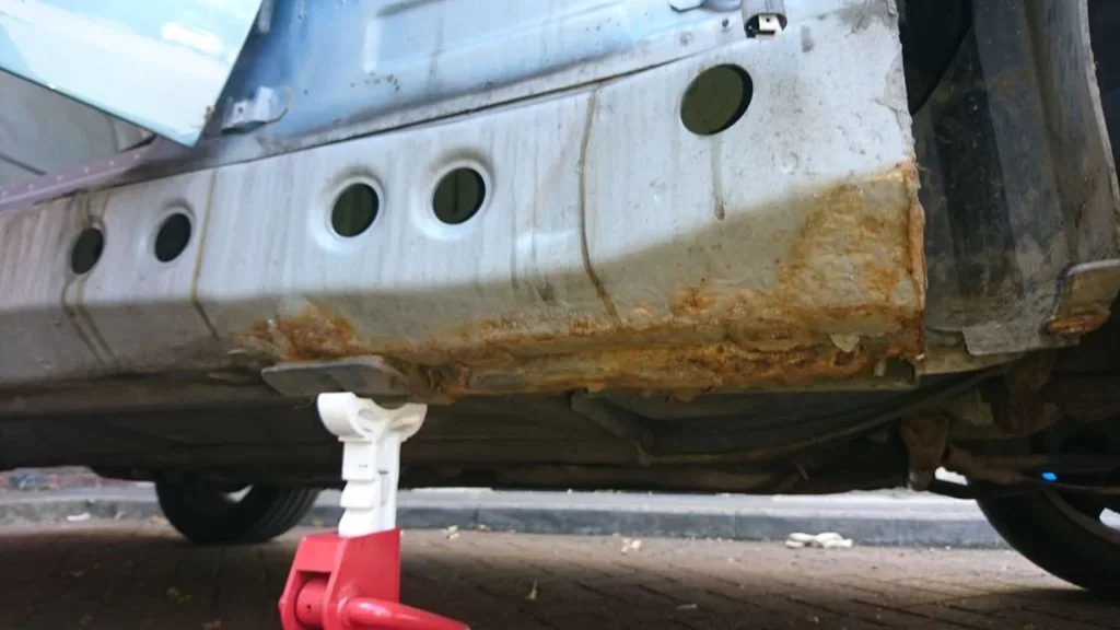

That looks roughly as bad as mine was, which was solid under the rust layer, but you'd certainly want to remove all the rust properly, treat and seal it. He's scraped off a bit of loose rust leaving plenty behind. If he underseals it now, as he says he will, then it'll continue to rust from the inside.
Mine:

This is as far as I've got with rust removal, just to give you an idea what may be left of the sill:
Mine:
Have you checked the MOT history here?
That is still very corroded and will be back in the blink of an eye, the layers need hammering off and the remaining rust grinding away and treating
Yes, I didn't have the time or gear to sort it fully. It'll be done properly when I replace the sill covers.
