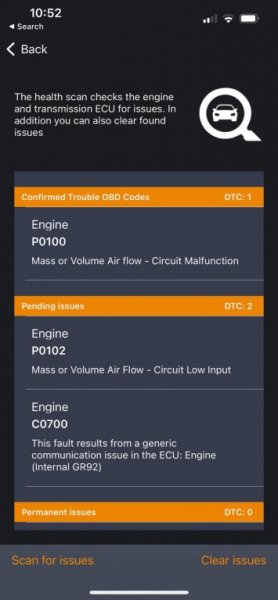

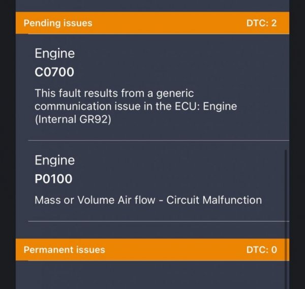

Another update. Plugged a generic (Carly) OBD2 reader in, cleared the existing faults and left the car running while stationary. Note that this morning she starts, idles and runs as she has done since a major service about 7 months previous - no issues with the throttle.
Three faults logged: P0100, P0102 and C0700.
See attached for the code breakdown.
Prior to clearing historic faults were references to camshaft position sensors and misfires, although I've not checked any faults since aforementioned service so these could well have been resolved. Can add screenshots if the attached sheds no light.
Thoughts?!
Cheers in advance.
Thoughts?!
Cheers in advance.

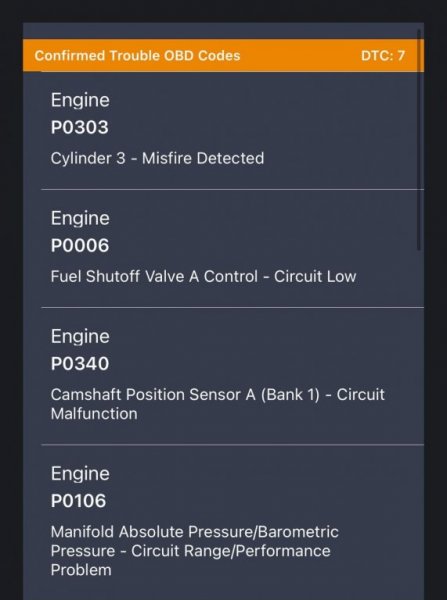

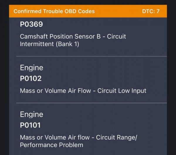

Did you make a note of the existing codes before clearing? You've not necessarily picked up the root error of the breakdown issue here from telling us faults after clearing codes.
I'm not great on generic codes. BMW codes will be much better known on here but will require a specific reader. Those descriptions could be generic terminology for the root issue elsewhere or you may have an incidental/additional error with the MAF.
What you had sounds a little drastic for the MAF. And probably for the other thing I'd consider which is the inlet camshaft sensor. Those faults also tend to stick around once they are there. A sticking throttle issue would come and go.

Yep - didn't dare consign the codes to history! Here's the full log before clearing (7 "confirmed", 2 "pending"). Note that a misfire was identified and fixed at the service so may be a red herring.
Don't have access to a BMW code reader.
Attached: 3 screenshots.

Got her to a local garage (Crowlas area) where, after much digging around and diagnostics, a brand new MAF was fitted. This led to smoother running and no cut outs, but the cam position sensor fault returned.
So I nipped down to Euro Car Parts and nabbed a mid-market cam position sensor and fitted that (hat tip to my brother and his handy toolkit).
Have driven about 500 miles since, over 3 or 4 weeks, and no fault codes at all. In fact, she runs smoother than she did before the summer and I'm perhaps even seeing an extra 1 or 2 mpg. That or Momentum 99 is substantially better than V-Power :D
