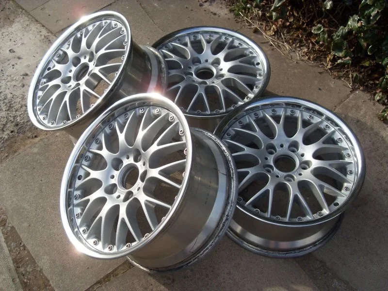

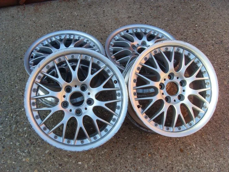

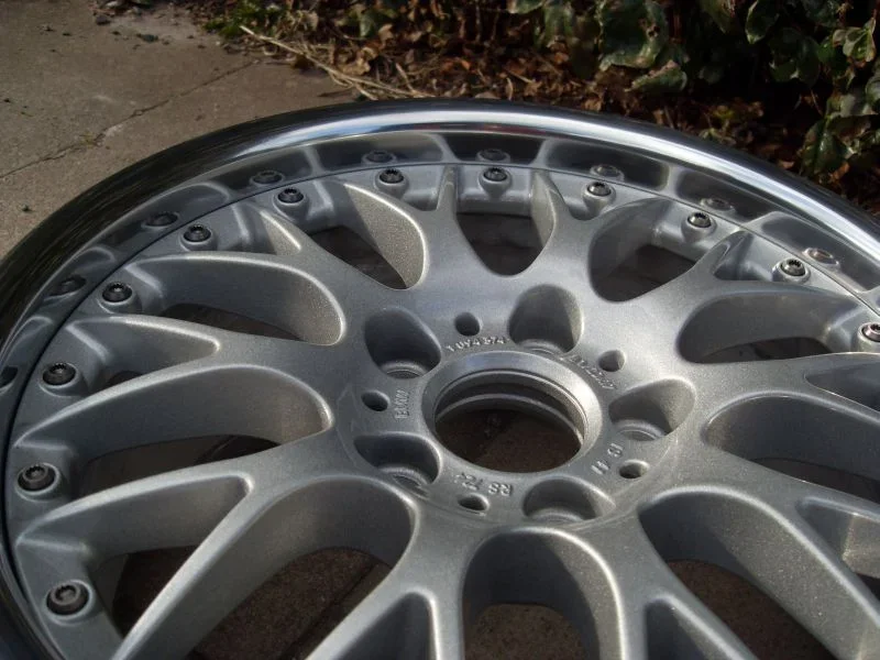

Hi,
It's been a couple of weeks so you might already be sorted, but I thought I'd just post that I used Pureklas to refurb my split-rims. Dav is very well known on the VW custom scene and his standards are incredible.
Proof is in the pudding though.....
Before....
After....
Close up....
He's a really nice bloke to deal with as well.

Thanks for the welcome (I realised after I posted that I hadn't introduced myself - have done now! :ymblushing: )
They were painted and quite grotty when I got them -
He split them, stripped them, powder coated the centres, repaired and mirror polished the rims and then re-assembled.
They do take some looking after though - regular application of jetseal109 or similar is essential to maintain the polished finish.
