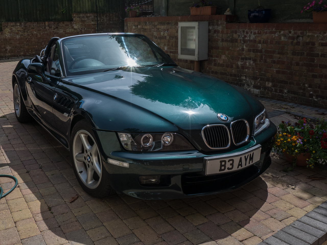

Here's Green Bum Car, aka Pocket Rocket (my wife and in laws in general like giving names to cars!). Short of changing wheels, I think I could add spacers to the back. From my reading with these style #18, I could add 20mm spacers...
So, Yeah, Nay? Is 20mm OK? I saw 2 models, one made of steel ( http://www.dvbcaraudio.co.uk/5x120-20mm-hubcentric-wheel-spacers-p-16077.html ) , one made of Aluminium ( http://www.ebay.co.uk/itm/231957978779 ) -- any preference?
