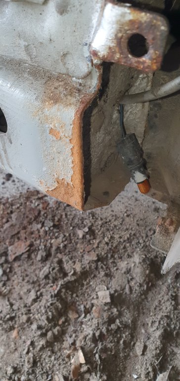

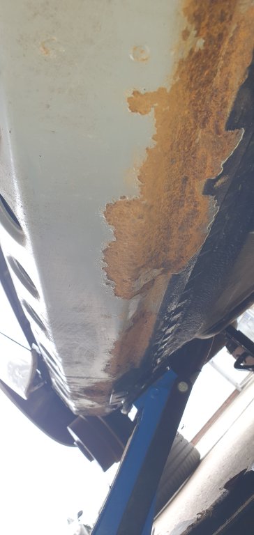

So have neglected this job for a few months. Have given it only one treatment of Deox but then nothing for 3 months. So have wire brushed and given another coat. Will continue this process over next few weeks and see how they look. Then maybe Hydrate 80, epoxy paint then top coat Hoping to pick up my sills from @spurs fan in a coupe this month and then all systems go...

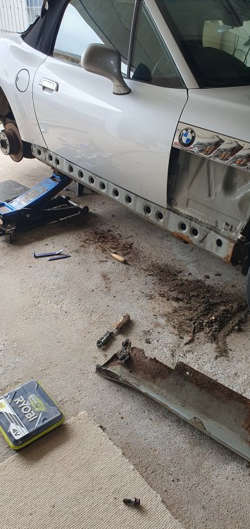

Applied waxoyl with a brush to the sills and rear of outer sills today. Can see how it blocks spray guns, thickened as I went along. Will try something to get it in the insides but failing that @colb is going to bring his sprayer when he comes to mine next week

@colb visited this week and used his compressor and schutz gun to get the waxoyl into the cavities.
Then we got the sills on. Car looking so much better with them on!
