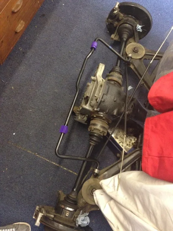

Wish me luck guys. My car is in pretty good shape other then an annoying rattle located on top of my fuel tank.
This weekend i'm taking her off the road for a couple of weeks to remove whole rear end and drop the tank.
While im under there i will be replacing all the bushings and couplings for goodmeasure.
I will get a few pics up along the way and keep you guys posted. Here are some teaser photos for a guy who did it in the states.

I would be wary of doing the the swing arm bushes with poly ones as they are known to start squeezing badly after a few hundred miles so best sticking with eom for those.
I would love to do this too sometime so would be grateful if you would post up some pics and a little writeup.
I agree about the poly bushes. It will put to much strain on the rest of the car so OEM is where i will stay.

Last night I finally gave up and repaired my existing fuel tank. (Long story) Once in "which was quite fiddly" the axle followed. Picture shows its cleaned state. Tonight’s jobs are to torque every nut and bolt then test drive.
brave...keep us posted im watching with interest
Its all back together mate, Used it this week for work. Only need to adjust the hand brake cable as its rattling a little.

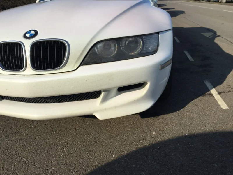

Custom designed LED halos

Yeah thanks @g8jka I trimmed 6 LED's on the inner rings. The rings sat perfectly against the lense with the help of some gorilla glue.
Yeah they have gone a little bluey, I turned the bightness down a little and all is well.
Lee
You got a link to the supplier of these Lee (ebay?). Always fancied fitting halos but been put off with the unreliability of flourescent tube ones so these seem a good alternative. Any chance of a close up shot of the headlight in daylight without them switched on just to see how obtrusive or unobtrusive they are behind the lenses when not switched on.
Cheers
They are ok but at the limit of what I can tolerate visually. Will see how I get on with them.
(Ebay: Xenon headlight RGB Multi-Colour LED Angel Eyes For BMW) £17.69
Apoligies on the filth on my car.
Mmm see what you mean, your first pics of them at night also look too bright but not sure if that is the camera telling a lie. I suppose they operate better as DRL's for use through the day and switched off when you have the headlights on.
How did the Mrs take to you using the oven btw :ymdevil:
@Aceman She was not impressed =))
The Halos are bright but you can adjust how bright with the remote and what shades of each colours, the options are almost endless.
