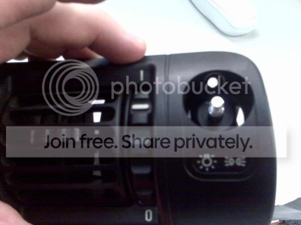

Remove this nut (8mm)
Screw that needs to be removed is the hole at the top of the hole left by removing the knob (knob is screwed on as well)

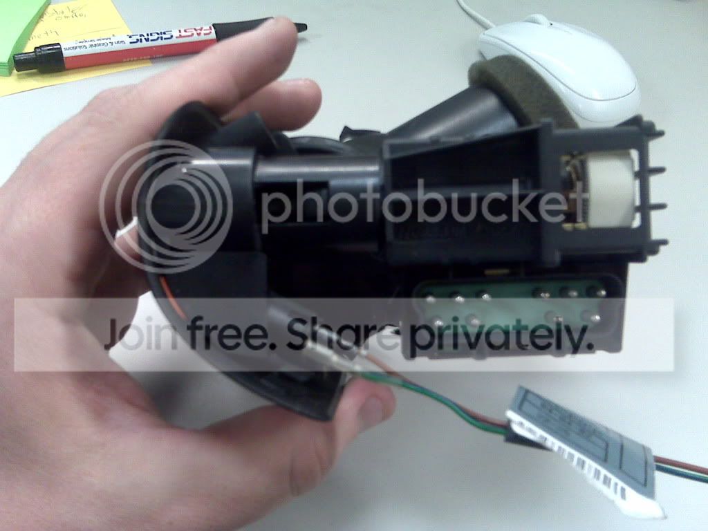

Now the whole thing pulls out. It's kind of tough to get out though.
unplug the wires and you'll have this;
Push in the tab here and...
