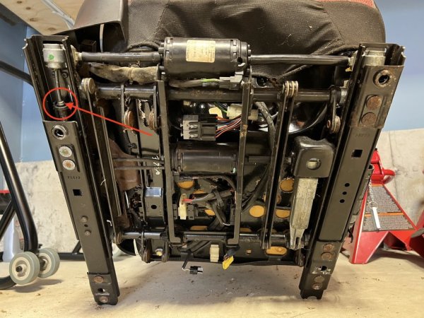

Hi Mario! I've been struggling to get the driver seat out for a few days now. The right track (the one closer to the center panel) moves using the manual "drill + spindle" method, but the left track is siezed. I upgraded my technique to the milquakee SQ1 bit to be able to transfer more torque to the tiny differential that moves the rail but still no luck (I discovered that there is another spring which then moves the rail. I can feel with my finger that once I start applying force, that second spring starts to twist which leads me to think the rail is siezed for some reason).
You mentioned above that the only other option is to remove the seat from the lower frame. Do you think you could explain the method? I am at a point where I am almost ready to cut the floor from underneath to release the seat.

Yeah I believe you. They key was to use the milquakee SQ1 square bit (similar concept to what what 2bmws mentioned above), and connecting it directly to the second (further) spindle which sits in the rail itself since trying to move the seat by attaching the drill with the attachment to the silver differential (I don't know if it's called a differential actually but it's the silver looking thing with a green dot in the photo that transfers the torque from the electric motor to the rail) only resulted in the second spindle (the one coming OUT of the differential) buckling because the rail was stuck.
Anyway, I recall removing the second spindle and attaching the square bit directly in its place (which required a long extension too because I have to approach it at slight angle) - this way I could transfer way more torque to the rail vs doing it through the differential and the spindle. Believe it or not, it still took hours of messing with it (with loads of WD40 all across the rail) before it finally gave up and moved.

No, I didn't remove it. I was able to approach the square hole (circled in the image) with the square bit 'head on' using a long extension, angling slightly upward because, as I am sure you're finding out, it's hard to 'connect' your drill to that hole directly because the differential is in the way. With a longer extension, there is 'play' in the linkage which allowed for enough angle to insert the square bit.
I also remember that it wasn't easy to remove that spindle going from the differential and into the rail. I think I had to pry it out (thankfully, it has some 'give', essentially being a very tight coil). You might want to be really careful there if you're trying to save the spindles (I wasn't because I had a new set of seats ready to go). Still, I am pretty sure I was able to 'save' those spindles when taking them out.
