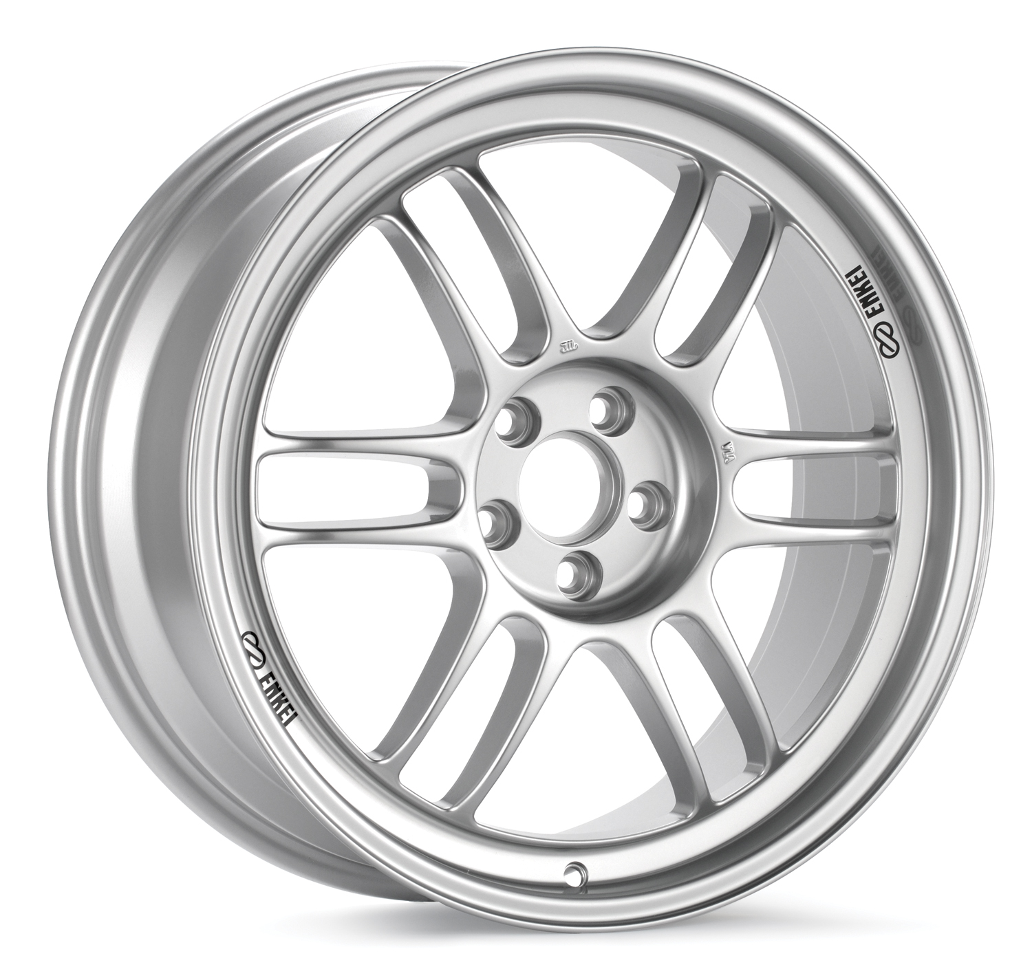

nice looking wheels Jason... i was all night last night looking at wheel designs, and manufacturers.. still at the moment i like deep dish alloys, or the concave type alloys but prefer 5 spokes, dont really want multi spoke wheels as they so much harder to clean... really liking enkei wheels i think its a rpf1...this
but will take my time and find something i really like, I been looking at genuine BMW designs but theres only a few i like at the moment i love the Z3M wheels... so the hunt continues...
