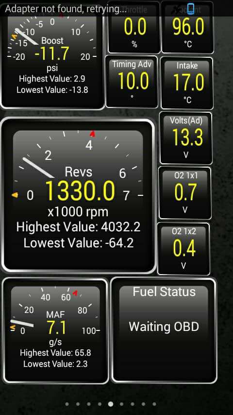

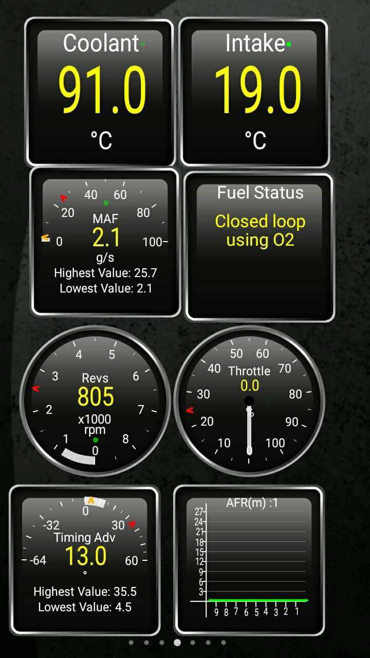

you can monitor actual engine temperature with an obd reader and the torque app i use it a lot its good to view other engine statistics too... mine will also verbally inform me when engine temperature has been reached... it would be good for you... my engine temp reaches about 97 degrees withing 3 miles of driving usually quicker if i am under load travelling uphill.. it will also drop by about 3 degrees when i turn on the cabin heaters...
21200872_353840258385727_7698799074940566206_o by handsomejackuk, on Flickr
21558953_358177424618677_6608485237815440445_n by handsomejackuk, on Flickr
