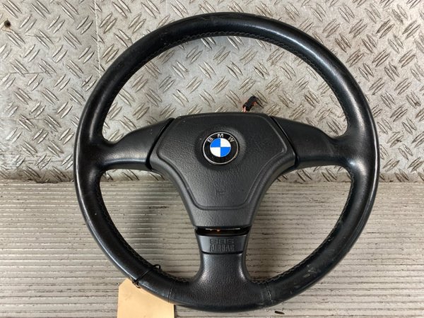

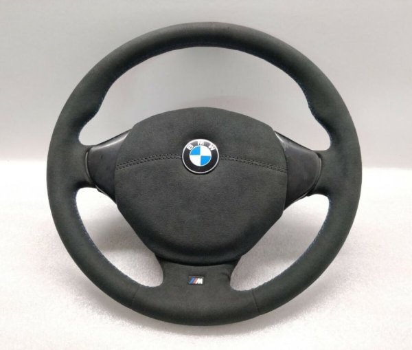

The wheels are different ill attach pics, the airbags dont fit both steering wheels, hense use different clocksprings
