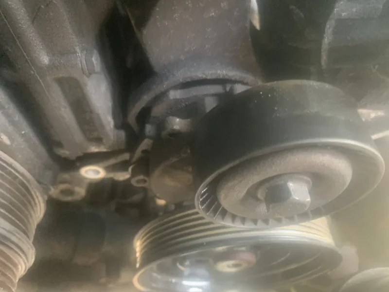

I’m just getting round to it now and I’m having issues getting the tensioner off (the unit).
Any advice to get the old girl off? I’ve even tried taking power steering pulley off but that sucker is stuck on tight!
Thanks in advance Nick

Just a follow up to this...
I have managed to loosen the tensioner off, wahooo!
However... it’s currently stuck behind the power steering pump pulley! I’ve removed the 3 13mm bolts and the thing is stuck! I’ve try tapping it with a mallet wiggling it back and forth and even wd40’ing it and it won’t even budge!
Worth investing in a bearing/pulley puller to try and pull it off?
Cheers
Nick
Not the way to go Nick, you need to loosen the pump mountings and swing it out of the way. Don't remove the pulley from the pump.
ps. While you have the pump out of the way and the belt(s) off have a good look to see if there is any leakage at oil from the oil filter housing. If there is you're more than halfway to doing that (very common on the M44) job too.
