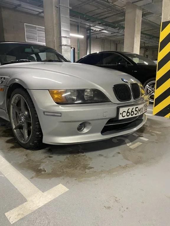

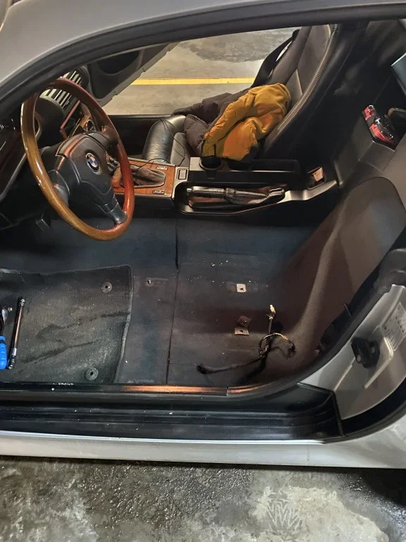

Hi friends! After 5years w/o z3 i finally bought my first z3coupe!
it is prefacelift arctic silber coupe 2,8tu with 4auto transmission.

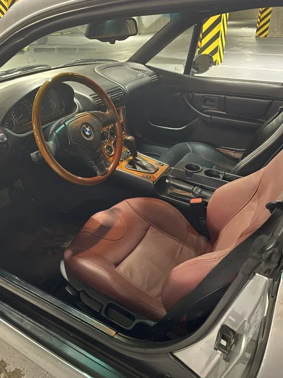

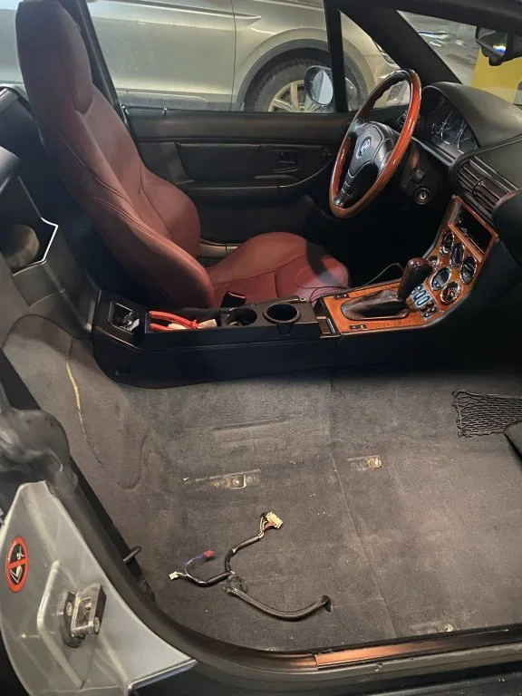

few minor mods done:

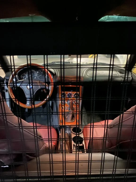

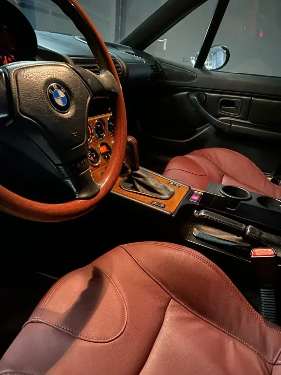

1) original bmw wooden steering wheel.

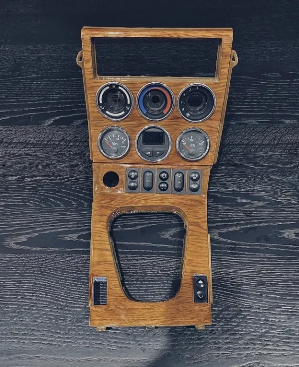

2) 3d printed and covered with natural oak z3 M central console shift and gauge trims , retrofitted facelift round OBC retrofitted buttons to work correctly (main problem was to rewire facelift defroster switch)

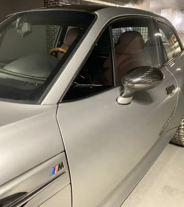

3) z3m carbon wing mirrors vacuum formed (not lamination)

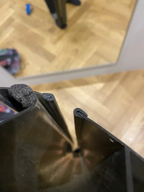

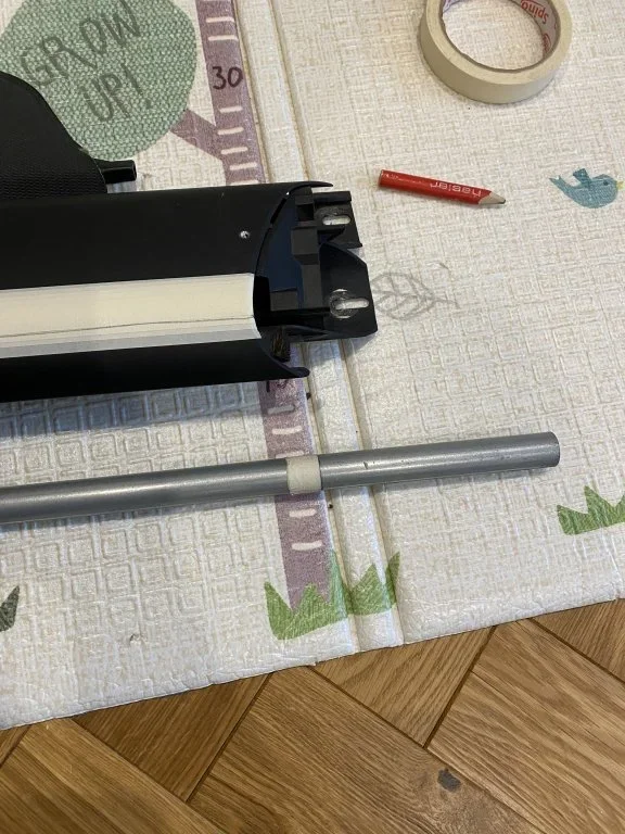

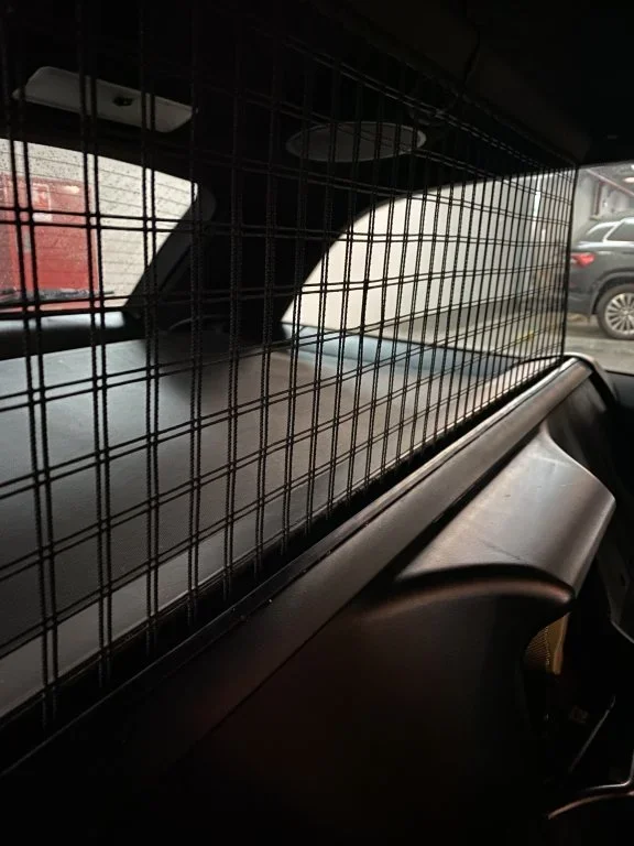

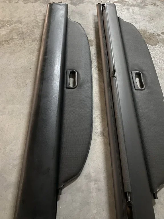

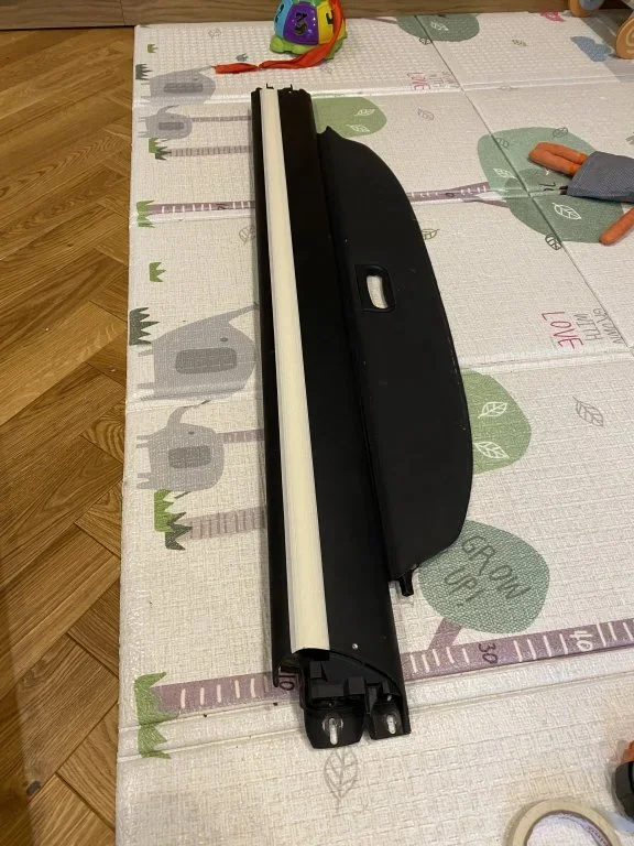

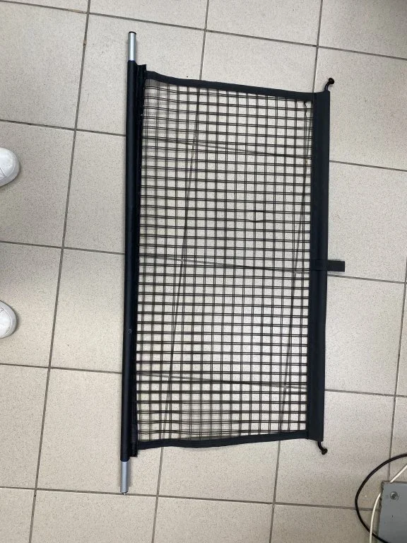

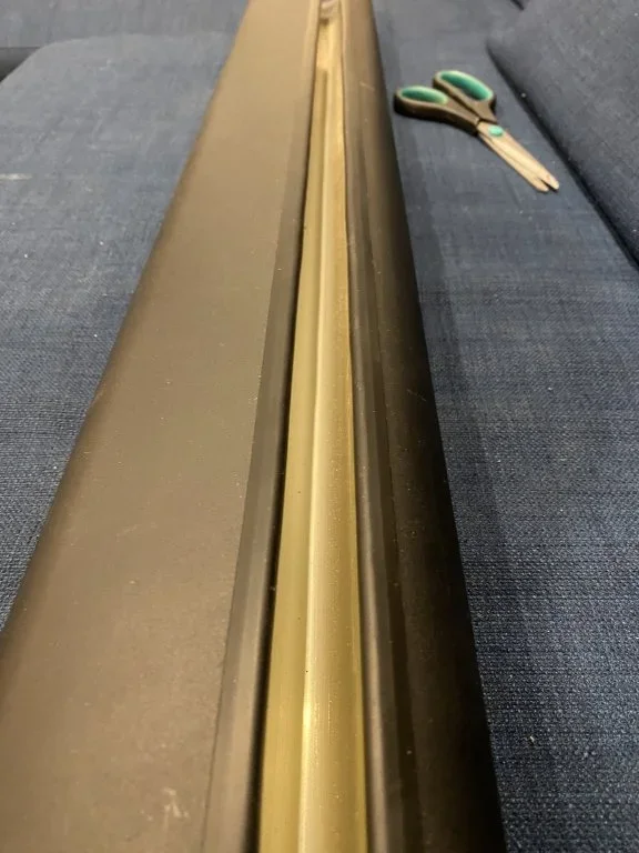

4) retrofitted trunk nest in to curtain w/o nest
Using components from e46 and e39 curtains.

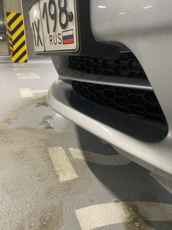

5) front Aero bumper

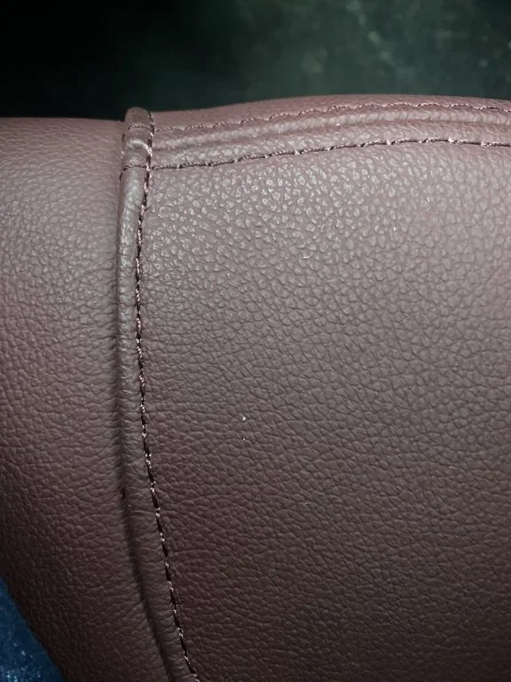

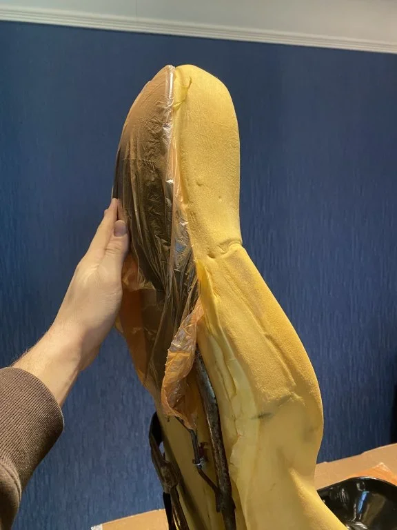

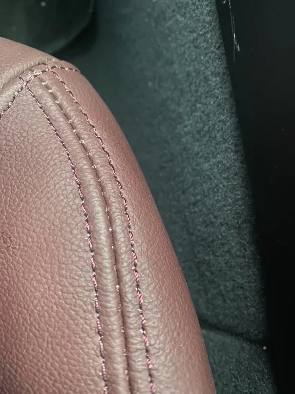

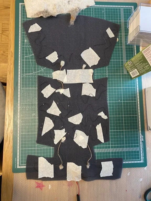

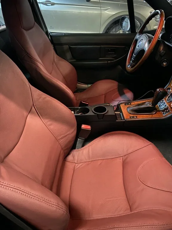

6) new seat skins from lseat.com (i bought coupe with roadster non sport seats )

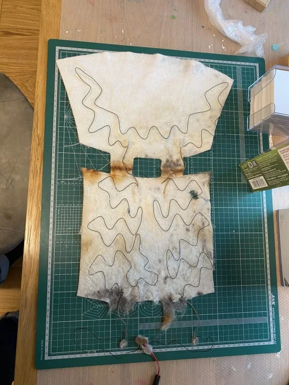

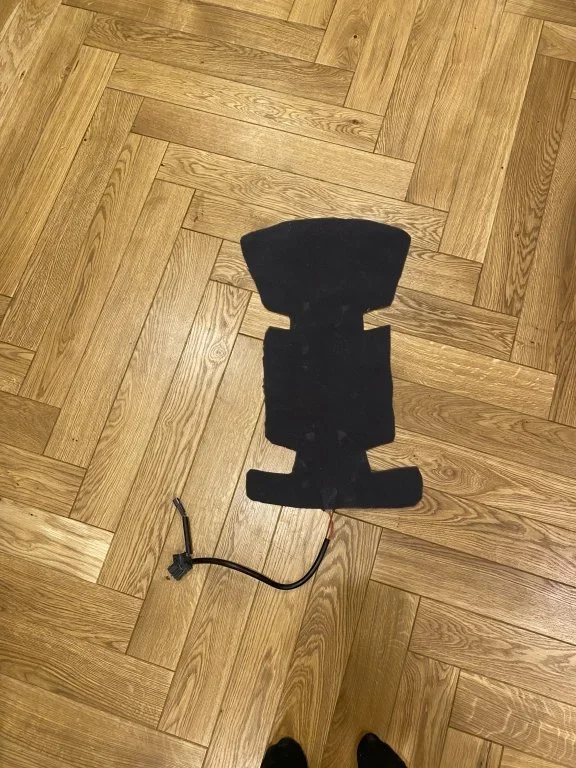

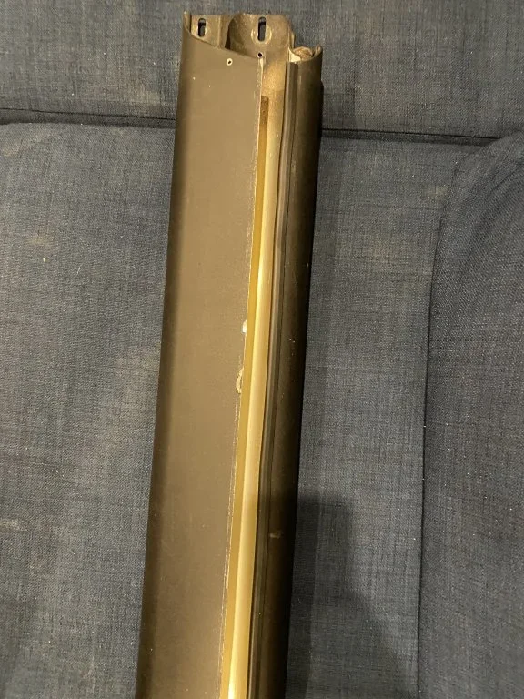

Repaired heat elements.

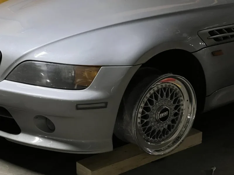

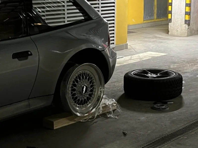

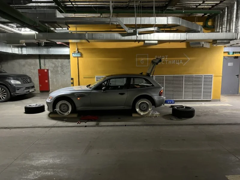

7) customised bbs rs027 (jaguar 5x120,65) rims
Srr comp
Front step from 16 to 17 8,5j
Rear step from 16 to 18 9,5j
8) soon will be swapped to manual
