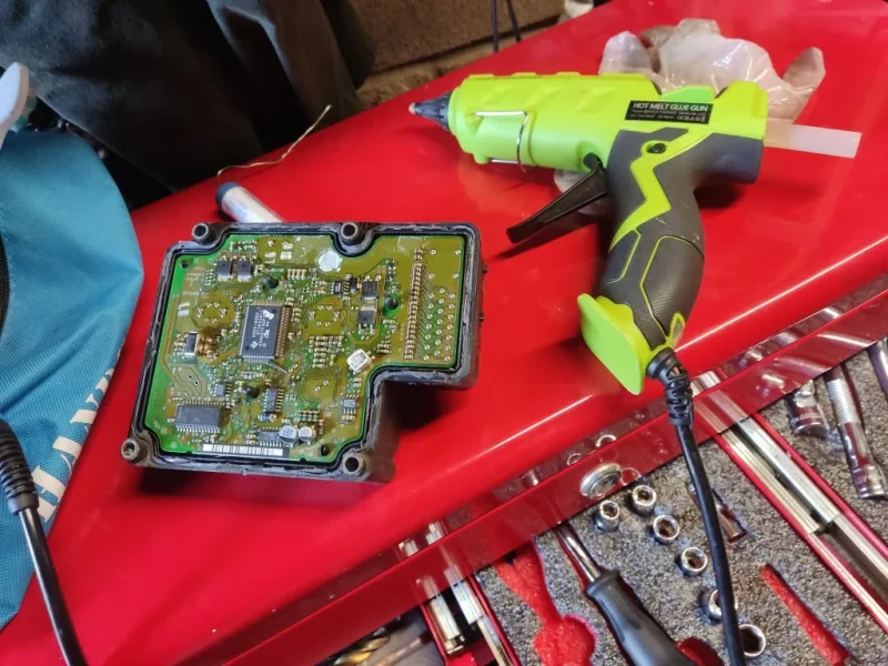

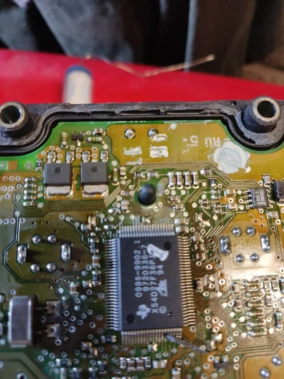

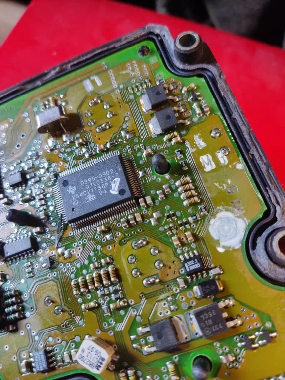

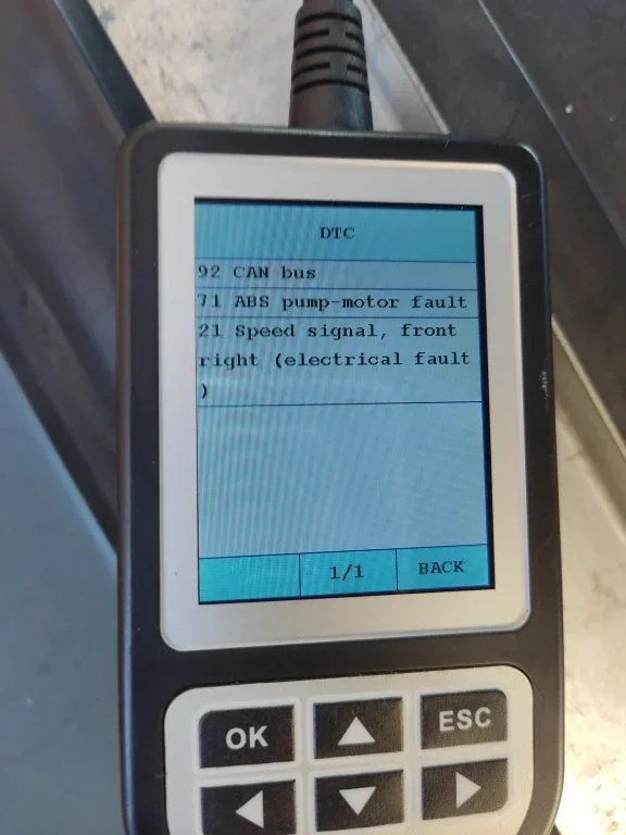

Then my ABS light came on, couldn't clear it so failed
Opened up the ABS module , resoldered the pins and I cleared it. Hope it stays that way
If it does I'll get get a second test and should be a clean slate
