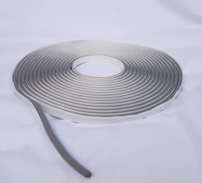

They are fitted to door with a butyl sealer something like this.
Thank you very much, I've just ordered some for next weekend! Does this need to be left to set?
