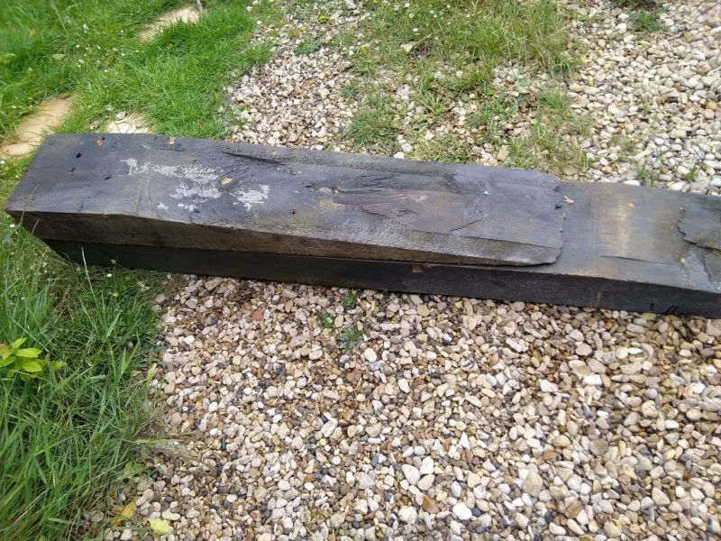

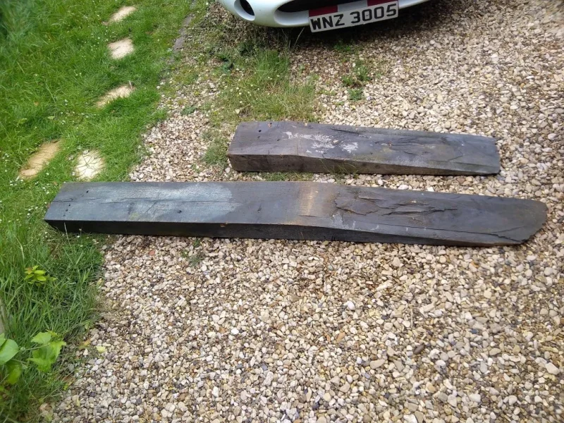

I changed the clutch on my 733i (long ago and far away) using steel ramps and axle stands on a gravel drive. The hardest part was getting a 2ton car up in the air.
More recently, having found that modern cars don't have clearance under their front and rear valances for my steel ramps; I bought a "garden centre" railway sleeper.
I sawed it in two as shown in the pics and drilled holes to drop in bolts to locate the smaller on top of the larger.
Improvements- could staple some chicken wire onto the slopes to guarantee anti-slip although I've never had a problem and...
end stops!
