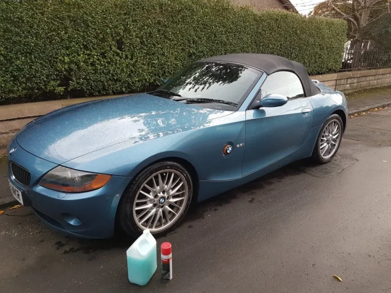

You cant just say you brought home a wee Z4 and leave it at that Conrad. What motor is it, what colour etc.=))
Hi Tony . Man blue 2.5 2003. Srry too busy driving it. I've been down to the shop 3 times for milk. Actually I think we're short of hair clips. ... and probably tomatoes.

Looking good, especially the wheels, MV1’s, but I am byest.
