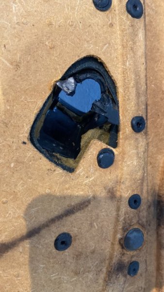

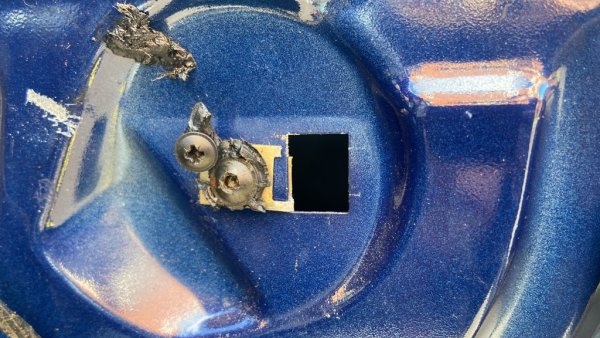

You see the two screws in your little picture. Normally you'd need to undo the bottom right one.
But it was already broken I think. I don't think that little philips screw is standard. Somebody has already 'fixed' it.
They are often broken though. And they cost an eye watering amount of money 2nd hand.
I thought the same about the philips screw 🤔
So I need basically a new door handle right?
Yeah. But as I said. They aint cheap. But occasionally you do see people selling door cards who haven't noticed the value.
It might be possible to do a temporary repair by getting a bit of bent tin and jamming it down the sides of the handle with a couple screws.
But keep your eye on the for sale section. Door cards do pop up when people change their interiors.
Also a couple of breakers with shed loads of stuff. Might be worth asking.

I built mine back up with fibre glass and a small piece of sheet metal. Works fine - just have to get creative!
