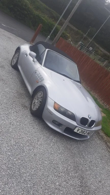

On my 2nd z3. Had a 1.9 which unfortunately lost an argument with a tree after hitting slip on the road. Gladly I was unscathed but sadly the zed didnt walk away as cleanly.
I've since bought a 1999 2.8 artic silver. Only home with me at the weekend.
First thought is the difference in acceleration is night and day.
2nd is I got it quite cheap (cheap for 2.8) so I'm aware it's coming with faults. One which came as an advisory on the MOT was a corroded fuel line.
I didnt think it was as bad until I got it in the garage and it was actually leaking (surely that is a fail?!) But anyway. Instead of going down the painstaking of sourcing a new one I depressurised the line. Cut it at the leaks and replaced the length of metal with a rubber fuel hose. Jubilee clipping either end. This has "resolved" the issue but I'm questioning if its MOT passable or just a good macgyver until I source a reasonable fuel line?
Sills are another thing which are going to be coming off along with the drivers wing. Hoping the inner sills aren't too bad. That's something I'm going to have to check and deal with over the winter. Father in law has been a fabricator his whole life and enjoys working at cars so he'll be a excellent but hopfully unrequired resource.
Another thing I've noticed is the ASC button doesnt seem to be working. I've noticed the light doesnt come on on the initial start so possible the bulbs blew/been removes so to check that but failing that. What troubleshoot method should I approach with this?
Bar those issues all seems to be good. Clicks on start but I'm assuming dead battery. Quick jump starts it and after a run starts again but it's not holding charge over any length of time.
Any tips and advice always welcome
