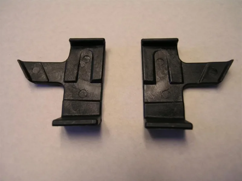

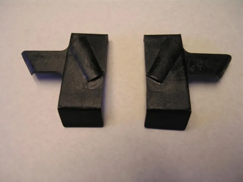

I've got a spare harness to connect the heated screen if you want it (message me and I'll chuck it in the post) and I would be incredibly interested in borrowing the little plastic spacers for aligning the top if you have actually managed to source those (I might have a go at creating a 3D printed version as well if I get my hands on some)
the thickness of the gauge not including the leg that apparently rests on the body panel is 6mm and including the leg is 12mm.
