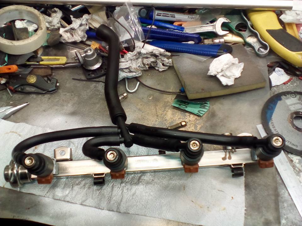

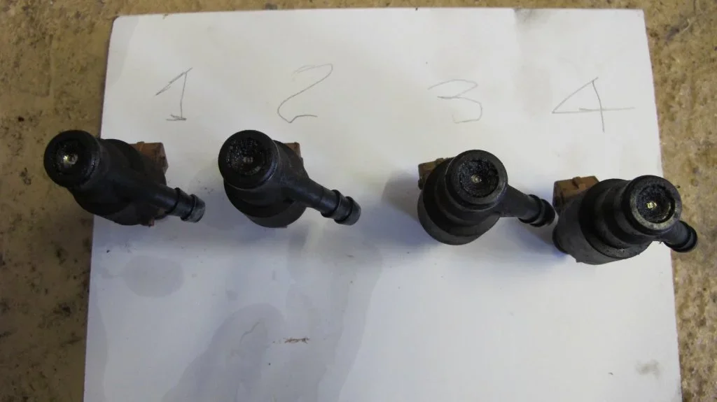

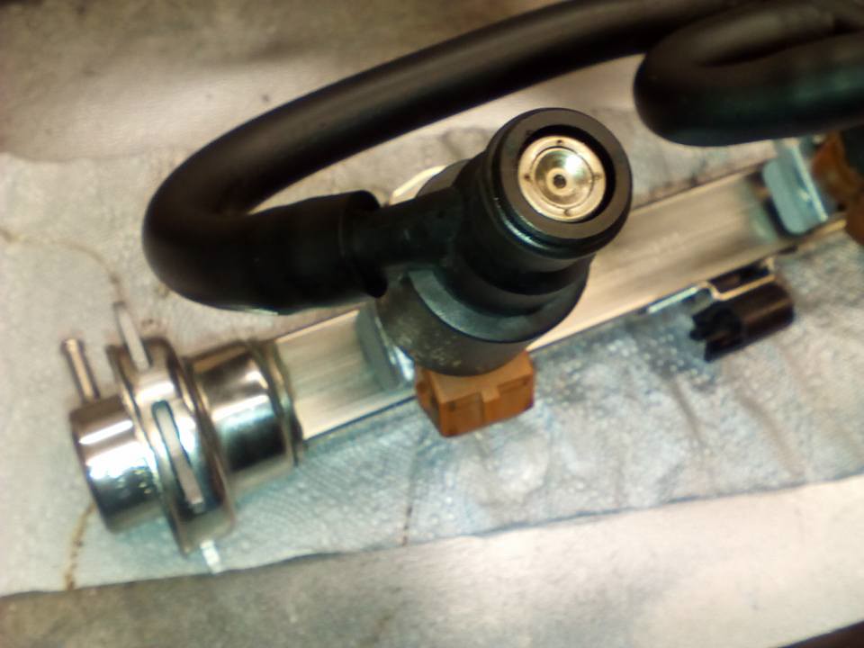

had mine done on my m44. i was lucky as my mate works in local college and did them for free... and flow tested them.. they were quite bad after 110,000 miles. came back like new and he said they all flowed much better too..
i didnt get a before shot but they were real bad and mucky...
21740203_359907971112289_7045000176636638694_n by handsomejackuk, on Flickr
21752076_359908107778942_8383198524709194715_n by handsomejackuk, on Flickr
21751826_359910444445375_6259189882130951434_n (1) by handsomejackuk, on Flickr
