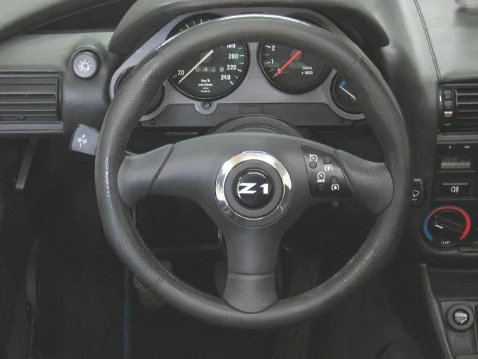

Aou can take the original E30 cruise control and adapt a control lever from the E34. The control lever of the E34 fits to the steering column of Z1 because it was taken from E34. ;)
I have implanted control buttons in the impact absorber of my 36 cm sports steering wheel in my car and they transmit the signals to the cruise control control unit by means of a radio remote control
