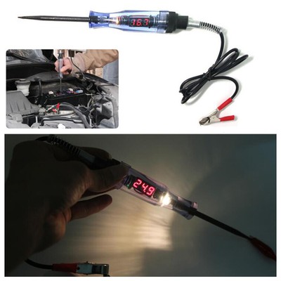

One other thing I would do is pull the roof operating switch out and disconnect the multi plug. If you have a 12v test light connect the earth clamp onto the door catch on the body then turn on the ignition, apply the foot brake and test each contact in the multi plug to see if you have power at the switch.
Something like this,
